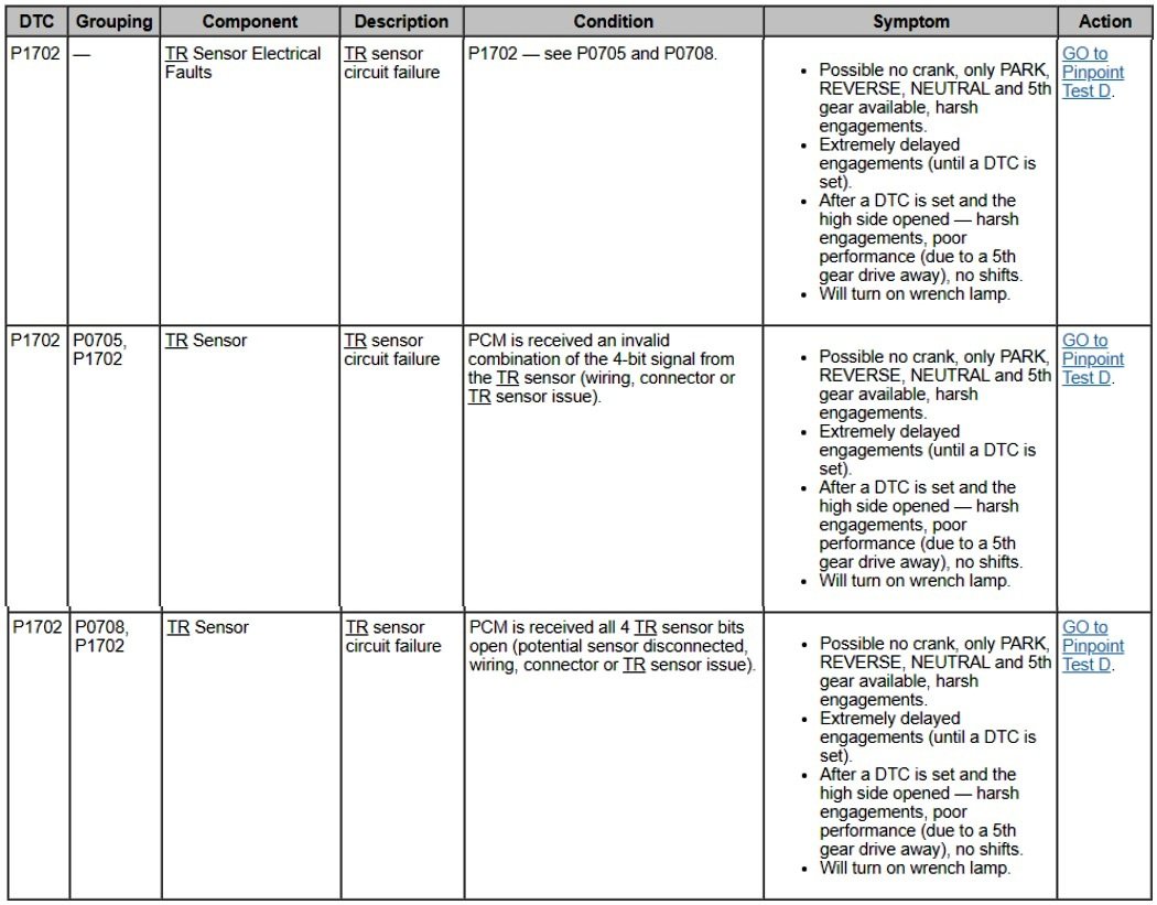

Per the Powertrain Diagnostic Trouble Code (DTC) chart in the 2009 Edge Workshop Manual, your Edge's behavior is consistent with P1702 Transmission Range Sensor circuit failure, which can limit transmission operation to Park, Neutral, Reverse, and 5th Gear only, with harsh engagements...

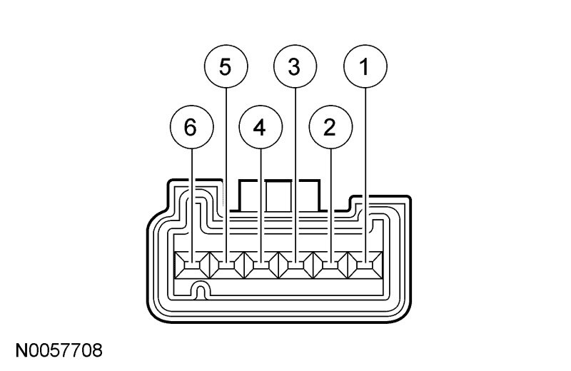

Transmission Range (TR) Sensor Connector Details
1234232448_TransmissionRange(TR)SensorConnectorIllustration.jpg.96b58f77e8ff8d878e2d767ef931dfef.jpg
Pin Number Circuit Function
1 Transmission Range (TR) Ground
2 TR 4
3 TR 3
4 TR 2
5 TR 1
6 Empty

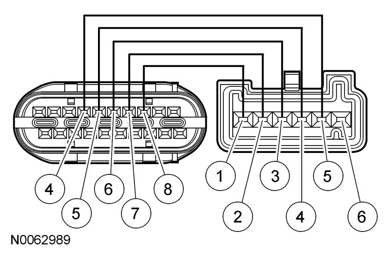

Solenoid Body-to-Transmission Range (TR) Sensor Internal Circuit Diagram Connector Details
1993558711_SolenoidBody-to-TransmissionRange(TR)SensorInternalCircuitDiagramConnectorsIllustration.jpg.b3d574293ba0fffad81b1c4d6c7992ea.jpg
Solenoid Body Main Connector Pin Number TR Sensor Pin Number Circuit Function
4 5 Transmission Range (TR) 1
5 4 TR 2
6 3 TR 3
7 2 TR 4
8 1 TR Ground
6 Empty
