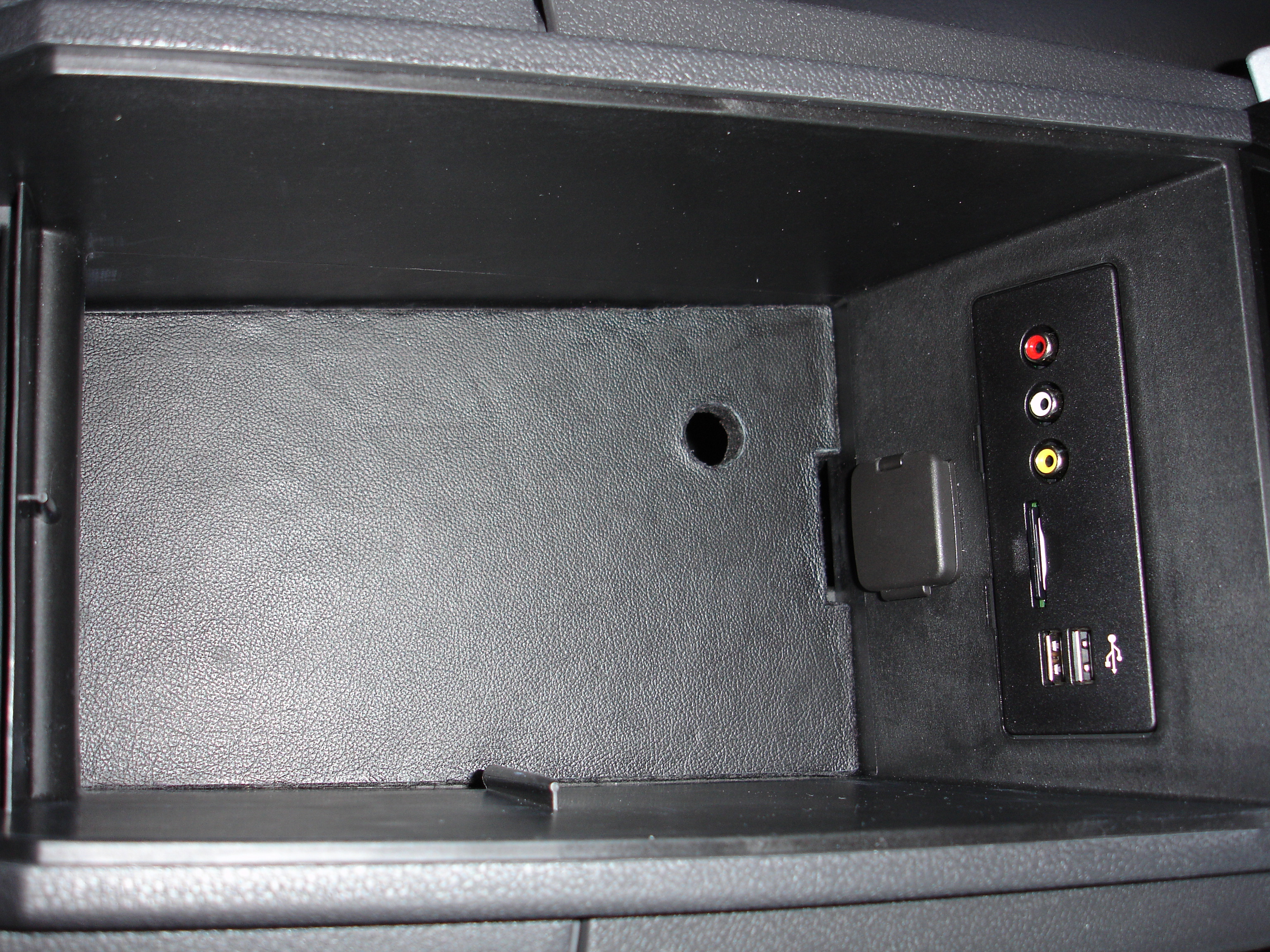

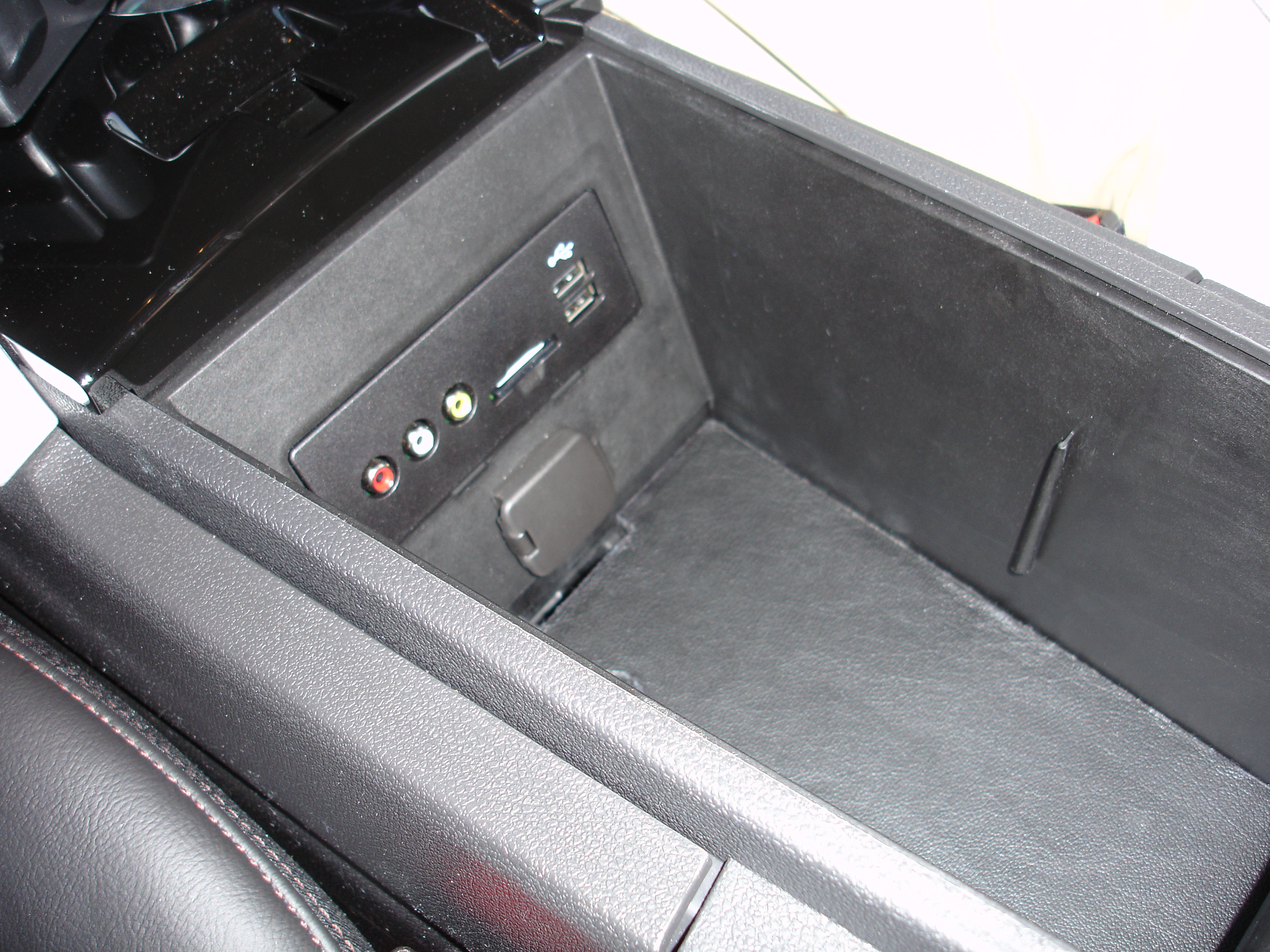

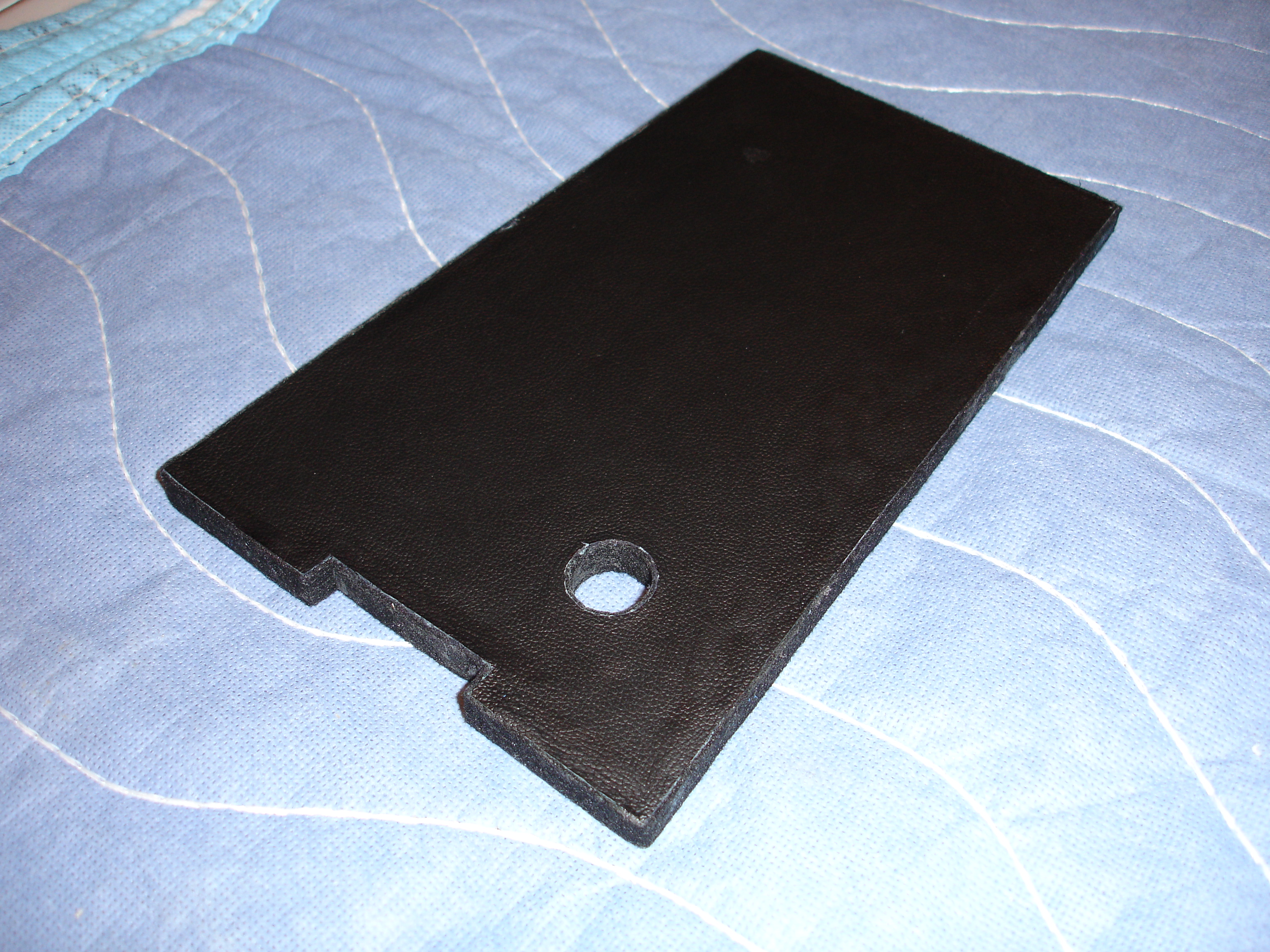

lraia Report post Posted April 1, 2011 First and foremost, KUDOS to Razorback for this project. Good for me on a rainy weekend. How I made it: The dimensions razorback gave were spot on. I used 3/8" 5-ply plywood instead of the "masonite" for this project. I also used a pretty stiff black felt to cover all side except the top, for that a used a piece of black leather. Used "Loctite" vinyl , fabric and plastic flexible adhesive to attach all fabric, worked great...purchased all supplies from craft / hobbie store for around $30.00, the piece of leather was the most expesive item, $13.00. I also reduced the dimensions 1/16" all around to accommodate the felt thickness. Drilled a 3/4" hole 1-1/2" from the drivers side and top for the finger pull plus a 3/8" deep x 1-3/4" wide notch on the top for the power outlet cover clearance. I can still remove the tray without removing the coin holder, not shown in pictures for clarity. the hardest part was attaching and trimming the fabric, just take your time its easy. All pictures are showing the top side. Thanks again Razorback, and good luck to others who fabricate. 3 Share this post Link to post Share on other sites

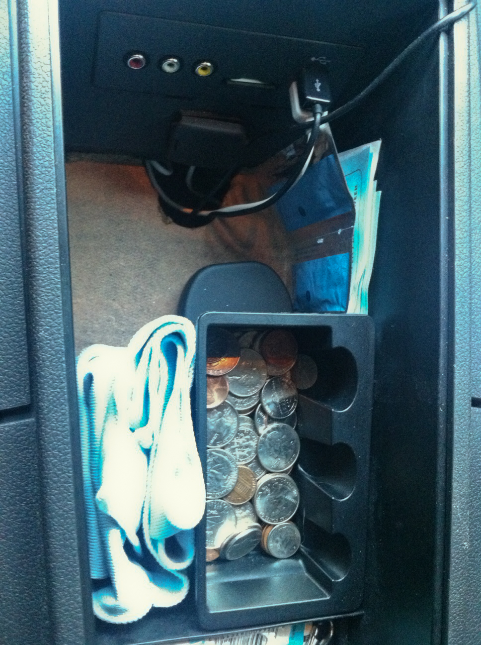

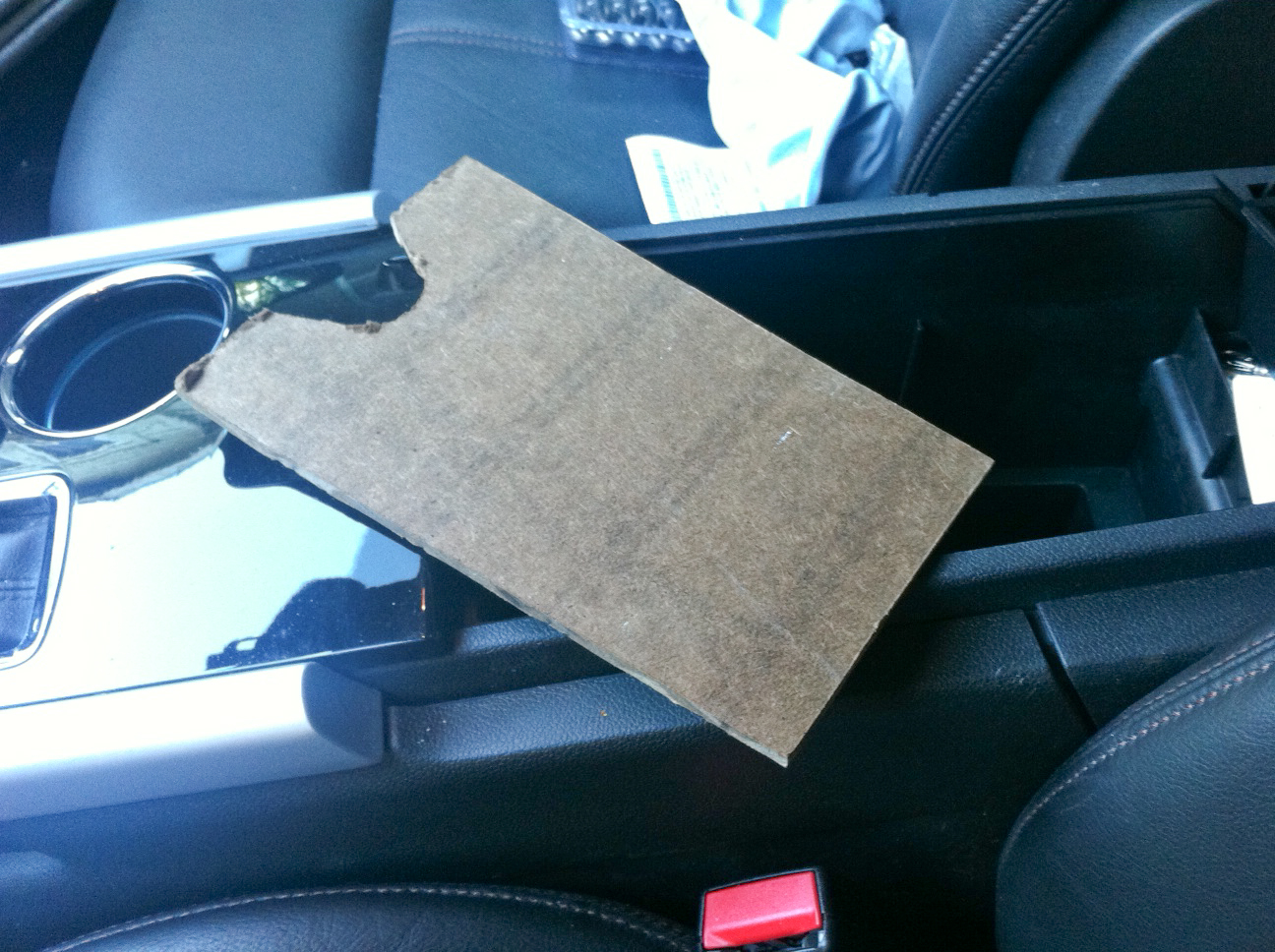

wilsons66604 Report post Posted August 30, 2011 (edited) Here are a few snapshots of my novice Prototype project. I think it would look nicer if I spent 12 minutes as opposed to 10 minutes on it. I like the fact that I don't have to unplug my USBs to remove the shelf. I drilled a 1 1/2 hole near edge then cut the opening with a hack saw. Yes. A hack saw. It was handy. (These shots really hi light the lame coin holder. Do you see any coins in the coin slots?) EDIT: I really like the shelf. Before I never wanted to use the ABYSS. You could loose your first born in that massive compartment. Now I can keep my junk below and keep my frequently used stuff organized. I used some Masonite bead board that I had left over from my kitchen remodel. Edited August 30, 2011 by wilsons66604 3 Share this post Link to post Share on other sites
