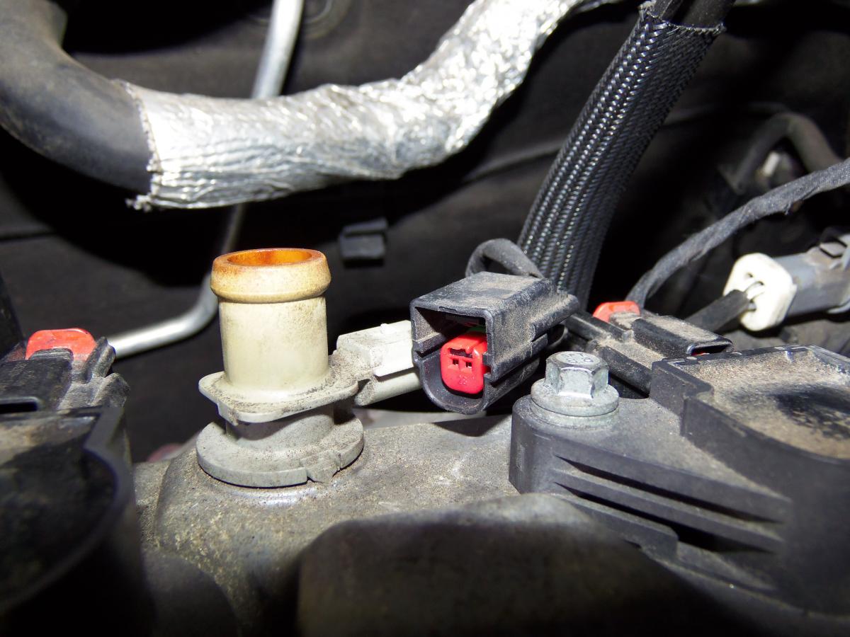

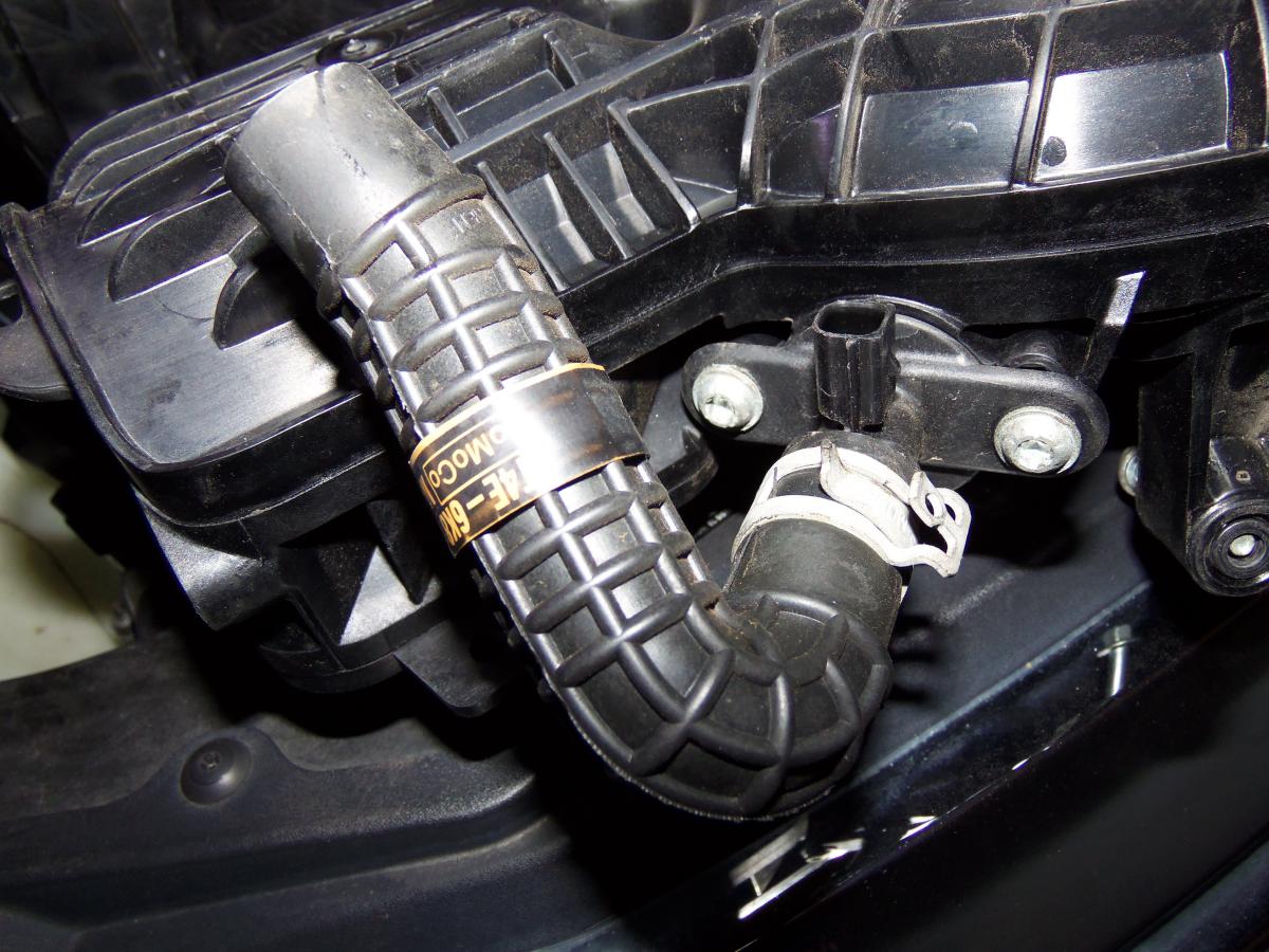

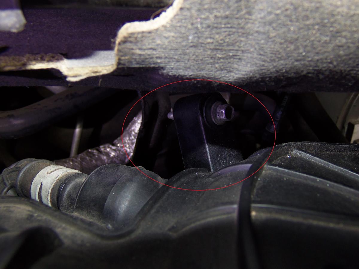

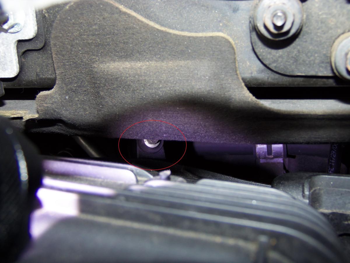

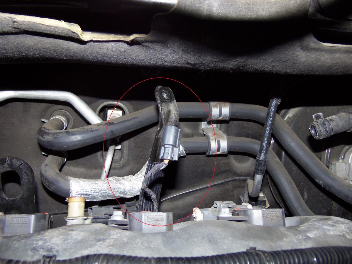

Had a bit of fun replacing the rear bank plugs. There's a brace at the rear of the intake manifold, well hidden on the Edge, and you can see it in the video above at about the 3:53 mark. Wouldn't see if unless you went looking for it. A 6-9 inch extension for the socket wrench should make it easy to remove. It won't fall out, will stay in the "bushing", IME.
post-23566-0-90757800-1431082267_thumb.jpgpost-23566-0-20671400-1431082284_thumb.jpgpost-23566-0-77530100-1431082294_thumb.jpgpost-23566-0-24863900-1431082307_thumb.jpg

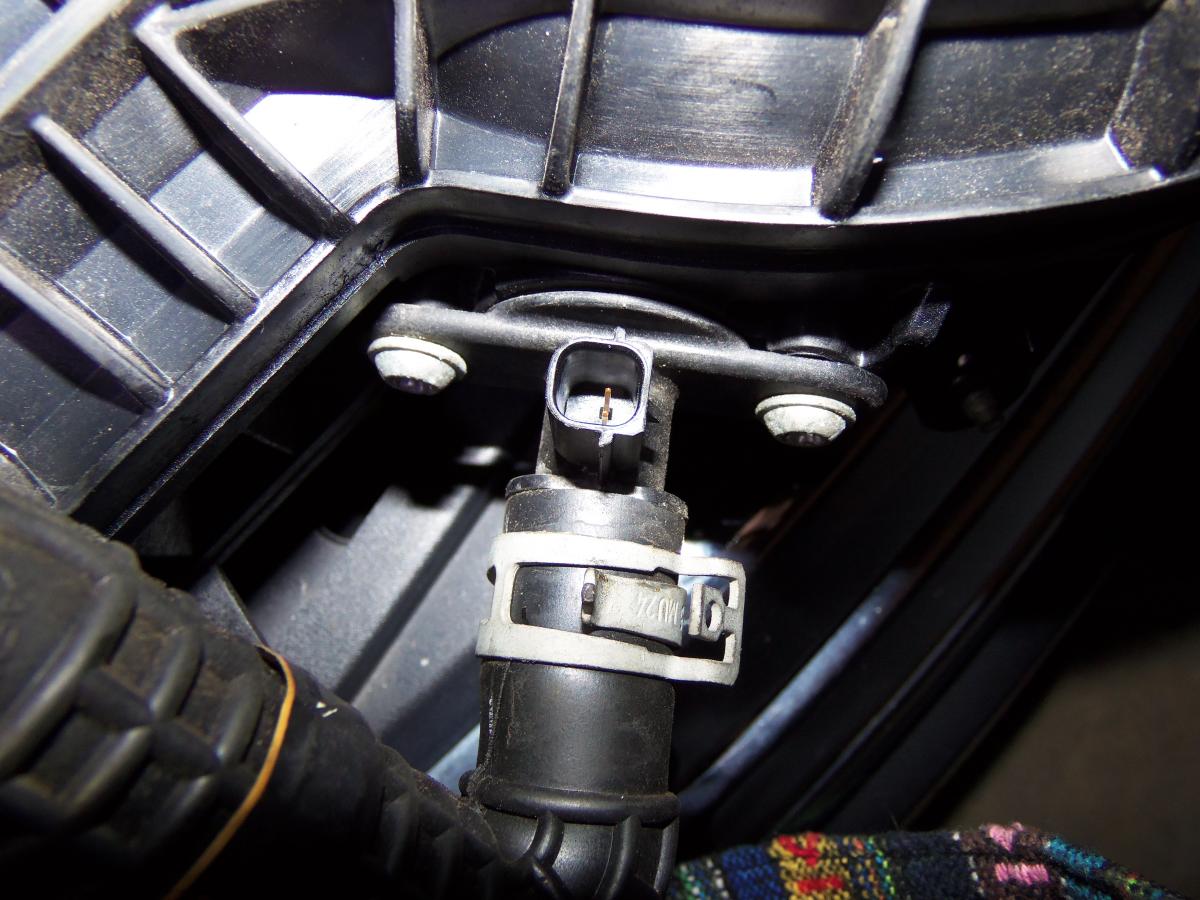

There's also an electrical connector at the bottom of the manifold on the manifold side of the PCV hose that you have to know is there and disconnect completely by feel. You won't see it on the intake manifold in the video at about 6:40 in.
Pulling the hose off the PCV Valve was easy (no clamps); did have to use a wrench to turn it and remove it though.
post-23566-0-76978100-1431082396_thumb.jpgpost-23566-0-91340600-1431082416_thumb.jpgpost-23566-0-35311300-1431082425_thumb.jpg
And the spring clamp on the brake vac hose were facing the firewall, so it made for a real joyous occasion :)

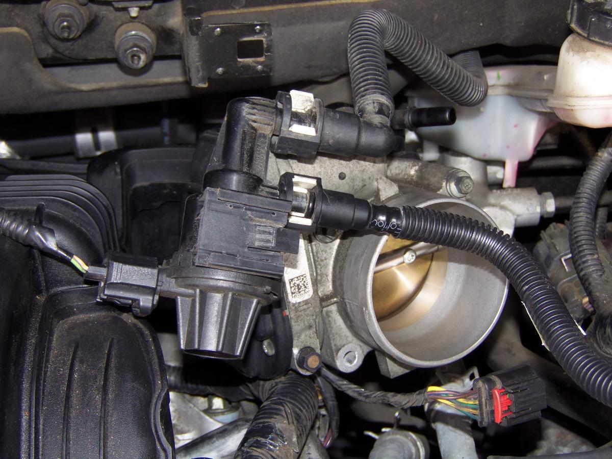

Easier for me just to slide the EVAP valve off the bracket and disconnect the electrical connector; much more freedom of movement.
And lest I forget, this is the DIRTY throttle body the dealership keeps telling me I need to have serviced:
