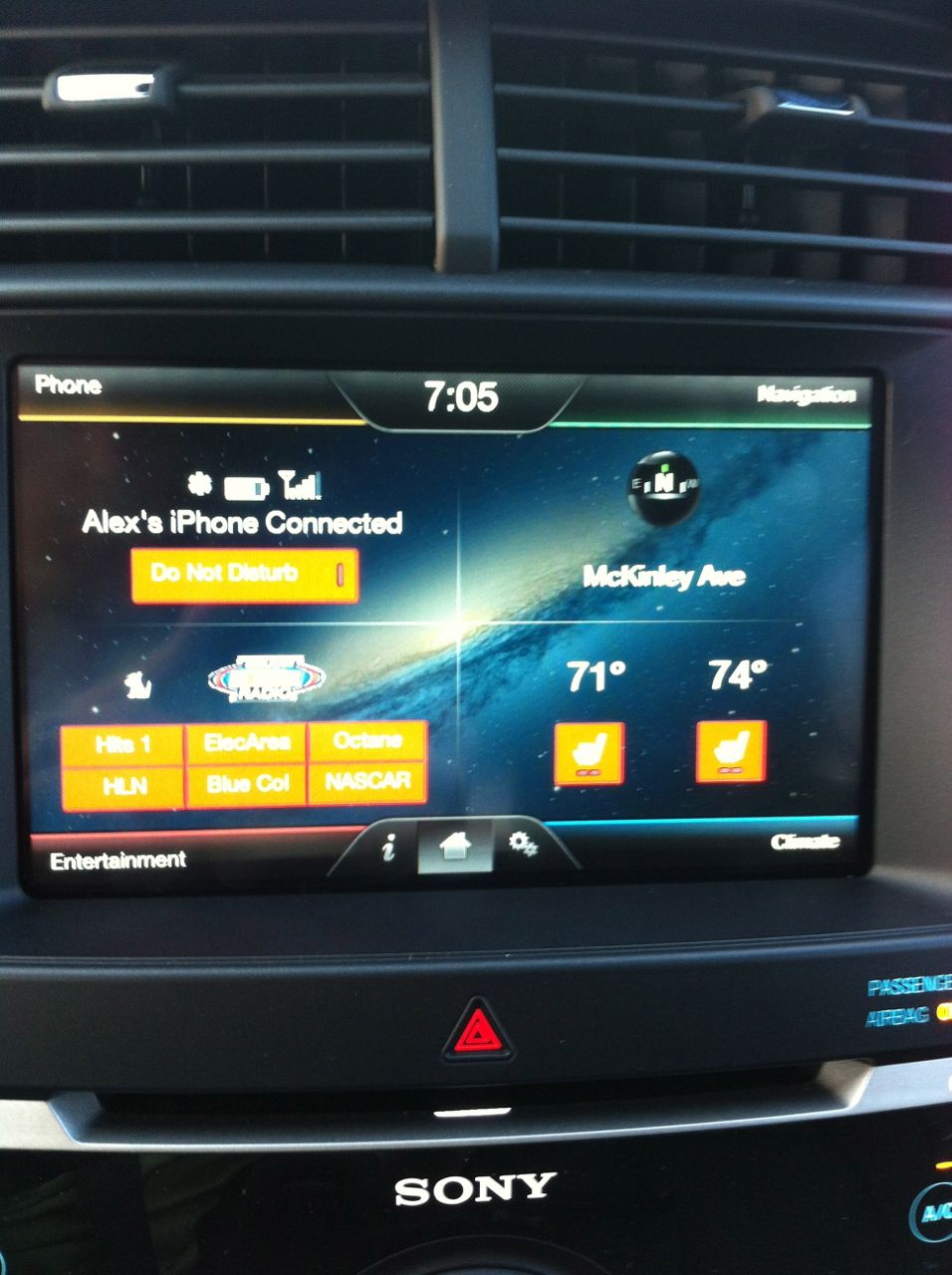

I took some pics of the screen... will upload them when I get some time.
On the bright side, I finally was able to see some of the 3D buildings (a lot of them in vegas!). They are cool. Prior to this update I only found one near me, but I didn't have a lot of opportunity to search. The Pond in Orange/Anaheim is 3D. (Honda center now or something).

Did mine yesterday (2011 Edge). Took about an hour. Like watching paint dry.... so I was doing other things arond the garage. No problems with the updates. I do miss the outdoor temperature readout on the center console. Seems silly to take it away. Also not too sure about the climate screen on the home page. 2 large font temperature readings? Too simplified in my opinion.
Received the update package today. It included an nice marketing tri-fold containing the USB drive and a SD NAV card. I went through the update process in my driveway and it completed successfully. Then I ran through some quick checks and when I reached the Ambient Lighting settings the ambient lighting turned off and I couldn't get them to turn on again. However, the ambient lighting turns on when I stop the vehicle, but turn off when it is running. I will run through a more extensive test tomorrow.
EDITED (for my opinion): Frankly, I expected much more from Ford after 15 months of ownership. Maybe my expectations are too high for a $45K vehicle? Would another $10K on a Lincoln got me better results? Not from what I've seen with the My*Touch. Sorry for the bummer, but the My*Touch is one big technology fsckup for Ford.
EDIT #2: I started the vehicle early this morning and the ambient lighting is working again. The MyFordTouch system's improved response is noticeable in this update compared to the previous version. This is where the system should have been when I originally bought the vehicle, or shortly thereafter with one of the many updates, not 15 months later. I didn't have time to run though a full test this morning and will do that this weekend and post my results and impression. Oh, you would think they could save the user settings to the USB drive during an update and copy them back, or offer a system option to manually backup/save the user settings. Ah, I'm rambling.
