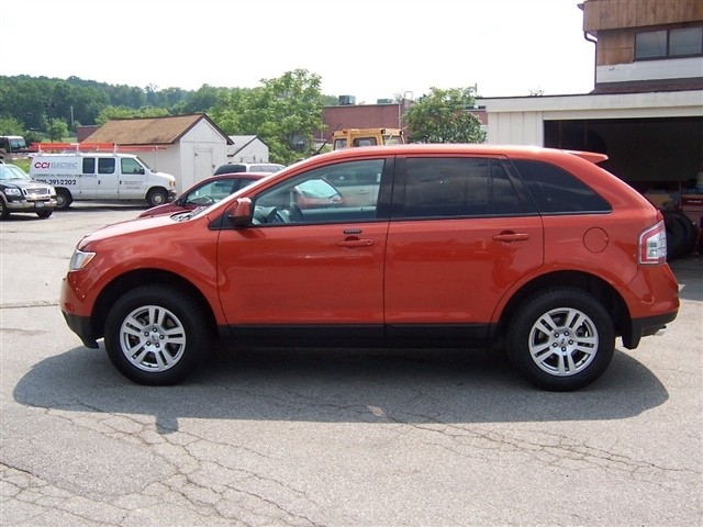

When I purchased my 2007 Ford Edge SEL it was from Dealer Stock so I did not have theoption of which radio to choose.  After a few weeks I decided to put in a Factory Ford Navigation Radio rather than go the aftermarket route.
