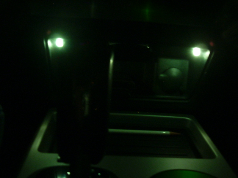

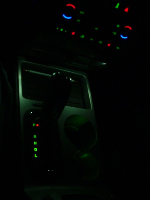

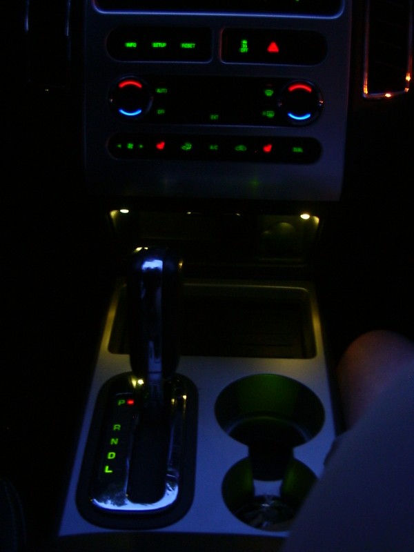

Thanks, I ordered them. Question: The way you positioned the led for the central console, would you say the light is sufficient?

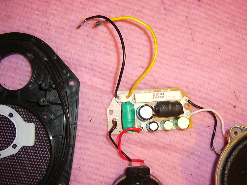

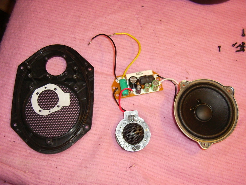

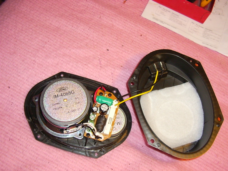

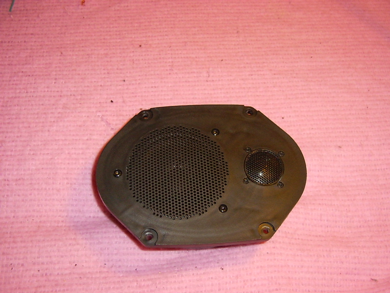

Ford Premium Audiophile Speakers taken apart

Lex, every time you wash your car or when it rains, water gets in the doors. There are drain holes at the bottom of the door to let it out. The back of your speakers are directly expose to that water/moisture/dirt. Of course, the door volume acts like a large encloser for your speakers. That how you got better bass response from your after market speakers. Norm -

I'm tiking of using the encloser to protect the 6X8 JBL speakers I installed in te doors. I know you installed Infinity Kappa speakers, have you ever wonder how durty they will get without protection? Norm -

Well, that is my next one. Glove box and center console have to be lighted. I already bought the plunger switches but I can't find those nice led you got on Ebay. Do you recall the vendor's name? Yes, I did put quick release connector for the door panel. I used those http://www.etco.com/

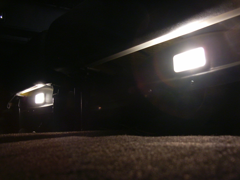

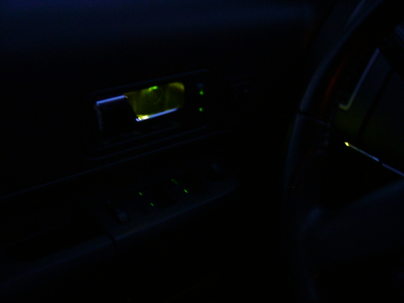

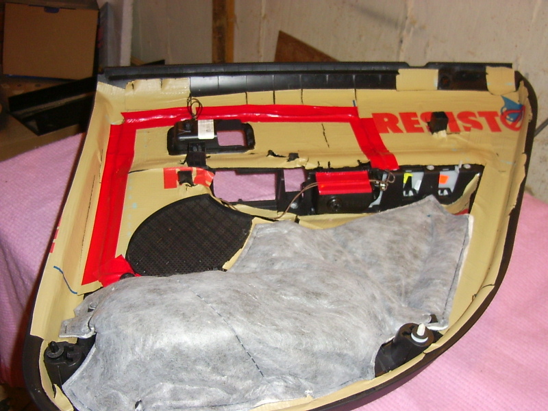

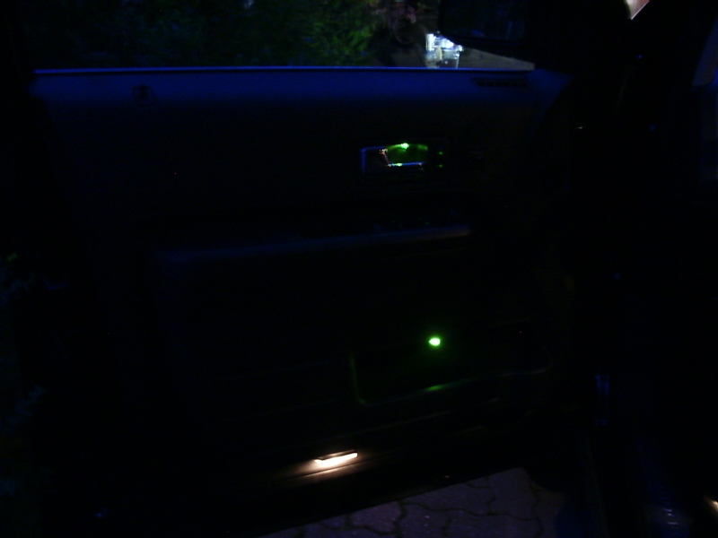

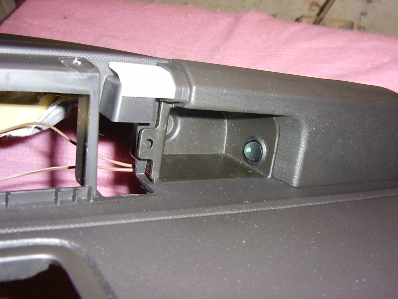

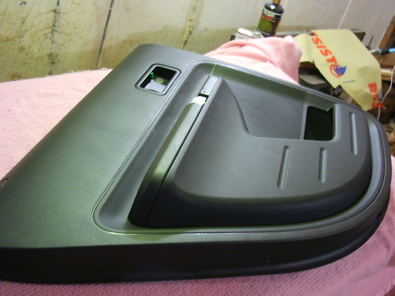

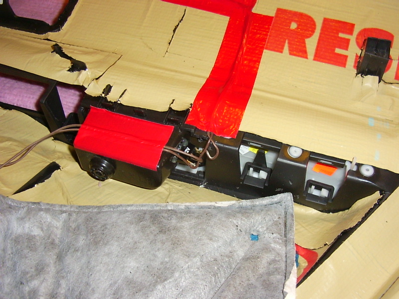

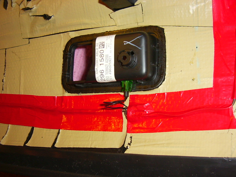

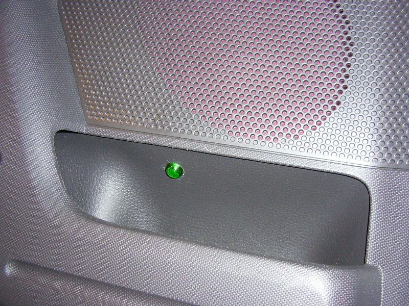

Another mod I did, is adding interior lights and switches. • Interior door handle lighted with a green led. • Door bin lighted with green led. • In door pod light. • Central console accent led • Under back seats courtesy light. As you can see in pictures, I took the interior door panel off and applied a sound deadener on the inside. During the process, I replaced the door speakers with better quality JBL 6X8 Speakers. I also added sound deadener on the inside of the door trough the speaker hole. It is very difficult to do, due to the restricted access hole. But overall, I’m satisfied with the end result. It’s quieter. The interior door handle led are simple to add. The power is taken from the 12V power window switch which stays on until the driver door is open or until the 10 minutes power protection delay. The door bin led is also powered by the same source. Both led can be switch ON/OFF by a lighted switch located in the recess of the door arm rest. At the bottom of the interior panel, I added a second pod light. I know, there is one outside under the mirror. I find it very practical on the outside, but once the door is opened I wanted to have one oriented toward the inside. It is connected to the mirror pod circuit, so it react the same. 2 lighted switches have been added to the central console. The right one controls 2 accent led that are illuminating the console. Gorgeous at night. It’s powered from the Blue+/Black- lead powering the light for the shifter. It can be dim from the stock dimmer. The left one is not yet connected. I hope to connect it so it acts like the “ON” position of the stock dimmer. Finally, the back seats access is originally illuminated by the rear dome light. I added a light under each seats facing the front seats. It is attached to the front metal bar, so it pivots when the seat are reclined. The power comes from the trunk light. Thanks for looking! Norm

It took me about 1 hour. I also notice how the switches are different on the 09. They are more of the windows swtch style. I don't know if the same mod can be done with those. Norm -
Hi, my name is Norm. I live in Montréal. I'm French Canadian, so please be kind enough to forgive my poor knowledge of the English language. I own a 2008 all black Edge Limited. I have it since October 2007. I've been a member of this site and a regular reader of most of your post since then but never posted myself. I've always been modifying my cars, but have to admit that you guys are really ingenious with it. So I adopted some of your ideas and trough in a few of mine. Interior lighting has always been my main concern with the Edge. Like most of you, I’m trying to add what should have been found as standard equipment. I have to admit, I personally find green interior lighting to be the best color of all. Especially with an all black interior. I know some of you prefer Blue. I guess it is just personal taste. The most satisfying mod I did, is getting the BARM controls to be seen at night. Thanks to Lex, great description, great research, big help. Norm
