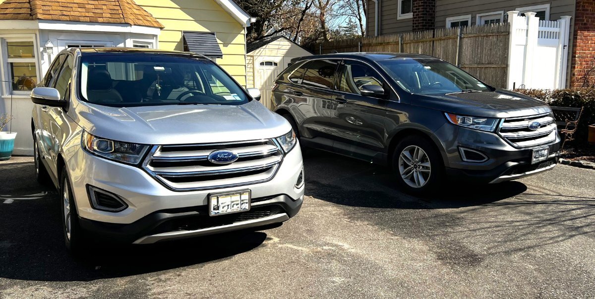

  1. I'm a long time lurker and decided to join! This forum has been a huge help with many issues. My wife and I have 2 EDGE's. Both 2018 SEL AWD 2.0L. She has the panoramic roof and I have a new long block thank to the infamous coolant intrusion issue.

    EDGES'S on Long Island
    His and hers 2018 SEL 2.0L... Hers has the panoramic roof of course. Mine (dark grey) has had the infamous long block replaced.
