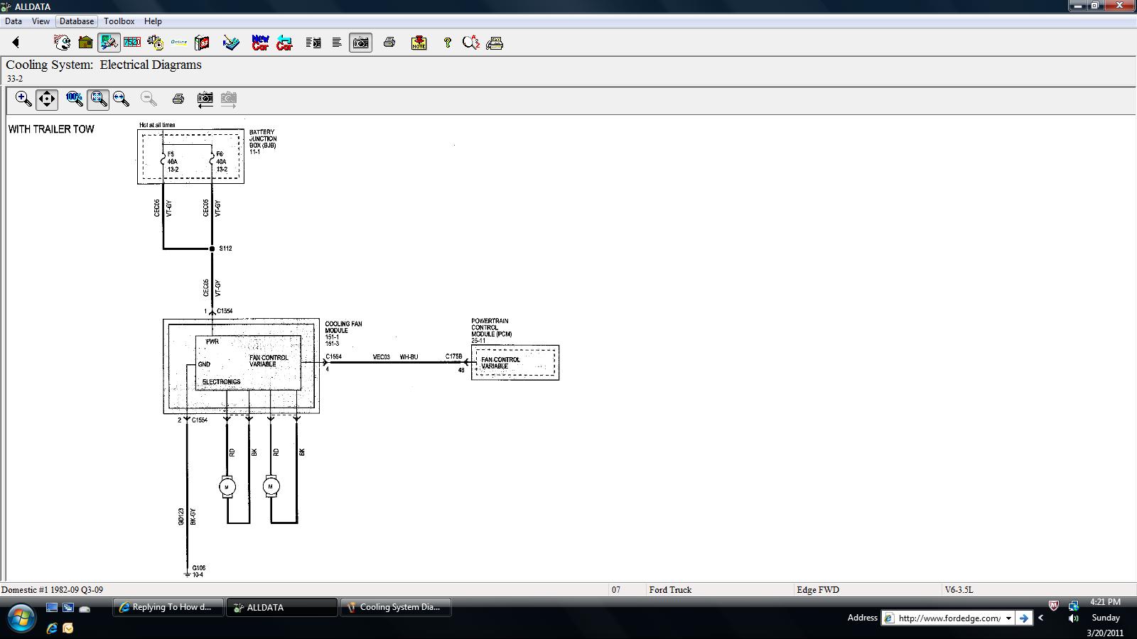

  2. CoastGuardian
    How do I replace a radiator fan switch?
    I have attached all the info I could dig up on the cooling fan electrical system. It looks like it is controlled by a module located just behind the radiator on the driver's side. I have attached cropped screen shots from ALLDATA. I hope this helps, It's everything I could find. Also, are you running FWD or AWD? all this info is for FWD.
  3. CoastGuardian
    I have access to ALLDATA, a computer program that will tell me where the radiator fan switch is located. let me see if the computer I installed it on is still running. If it is, I'll post the diagrams and specs on what you need, where it is, etc... I had this problem on my first car, an '82 prelude. I replaced the relays twice (at $100 each) before I decided that I just wouldnt let the car idle. Running without a thermostat helped a lot in the summer, But it sucked in the winter.
