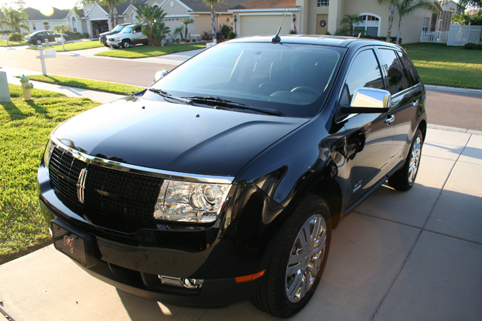

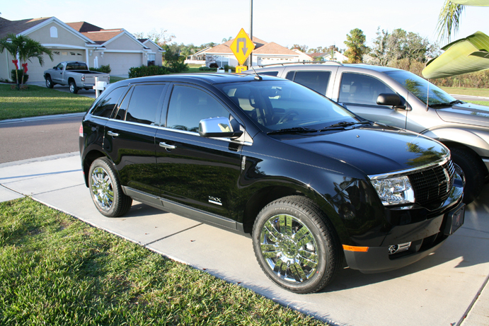

BTW, when I was working on these interfaces I fell in Love with the MKX, so much so I bought one! If you have any questions feel free to email me at gary.mazur@aampofamerica.com. I do not check these forums often, so email will be the best way to ask questions.
