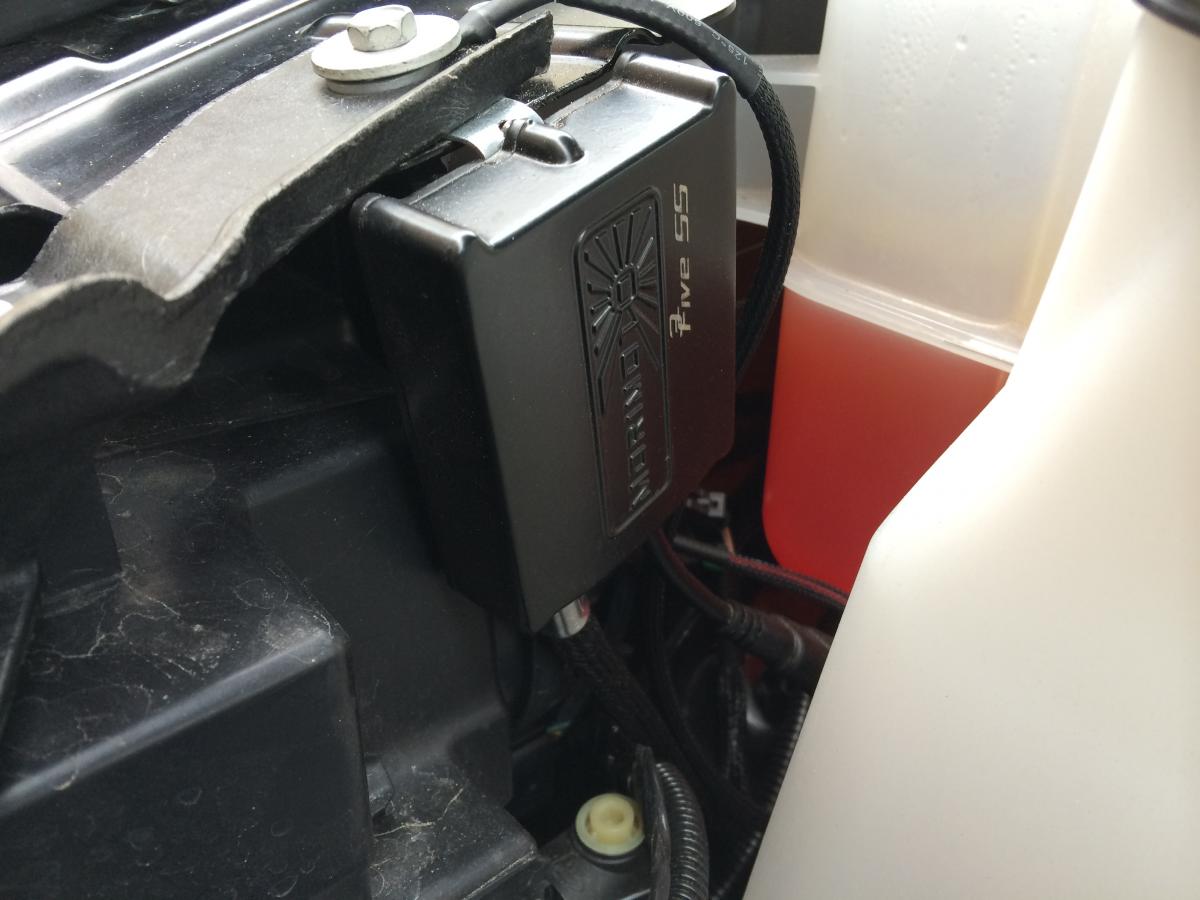

I ordered the TRS Morimoto 9012 kit with 35-watt ballasts and 5000k bulbs. In perhaps an over abundance of caution I also ordered the relay harness. I only recently noticed that they sent me 55-watt ballasts. After reading candurin’s description of the 55-watt system, I am glad that they did. In hindsight they probably thought I wanted the 55-watt system since I had sprung for the relay.
I mounted the ballasts behind the headlights using the bracket that came with the kit. The relay is mounted on an existing bolt on the firewall. Cover up the wiring with some black plastic split wire loom and you will have a very clean installation.
