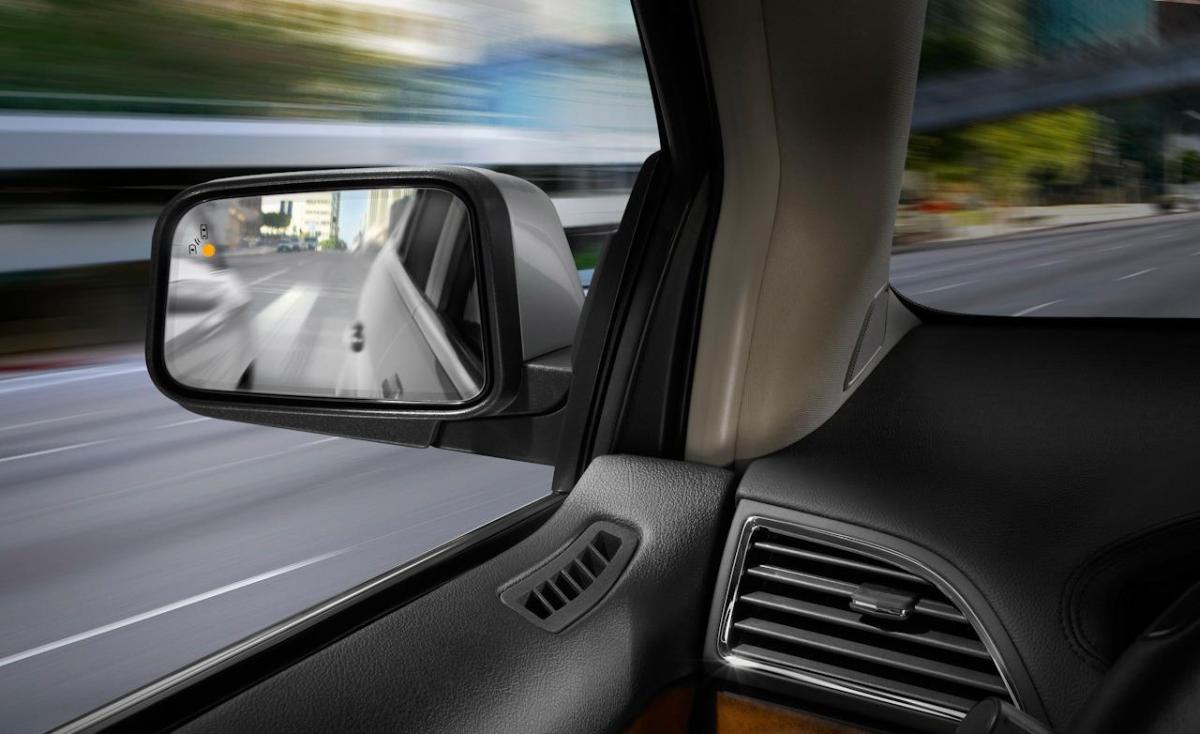

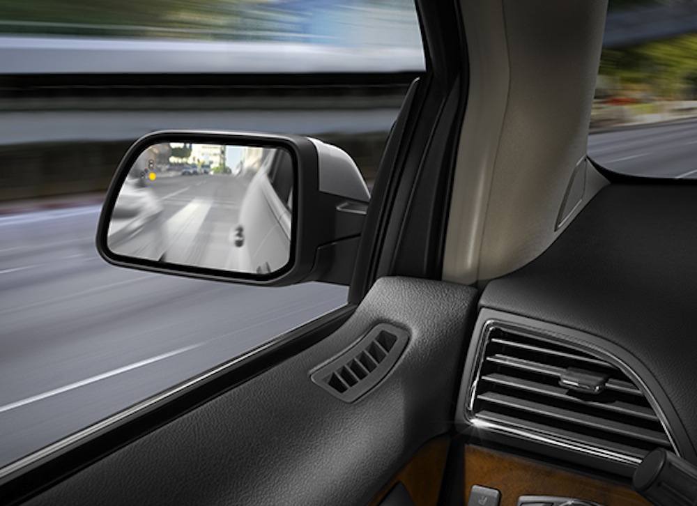

  4. Maybe both your Edge and MKX have the same newer, more streamline mirrors? I've been researching and looking into why they were changed between 2011 and 2012-2013. Maybe for wind noise or drag coefficient? All I know is that both my wife and I notice that they are drastically different in size (I drive an F-150, no visibility problems with that tank). I actually managed to find 2 of the exact same picture, one is a 2011 and the other is a 2012-2013. Same angle, looks like pretty much the same picture though one has obviously been edited to include the newer mirrors. Glad I found these, really shows the difference clearly!
