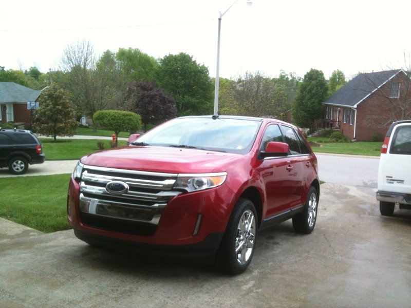

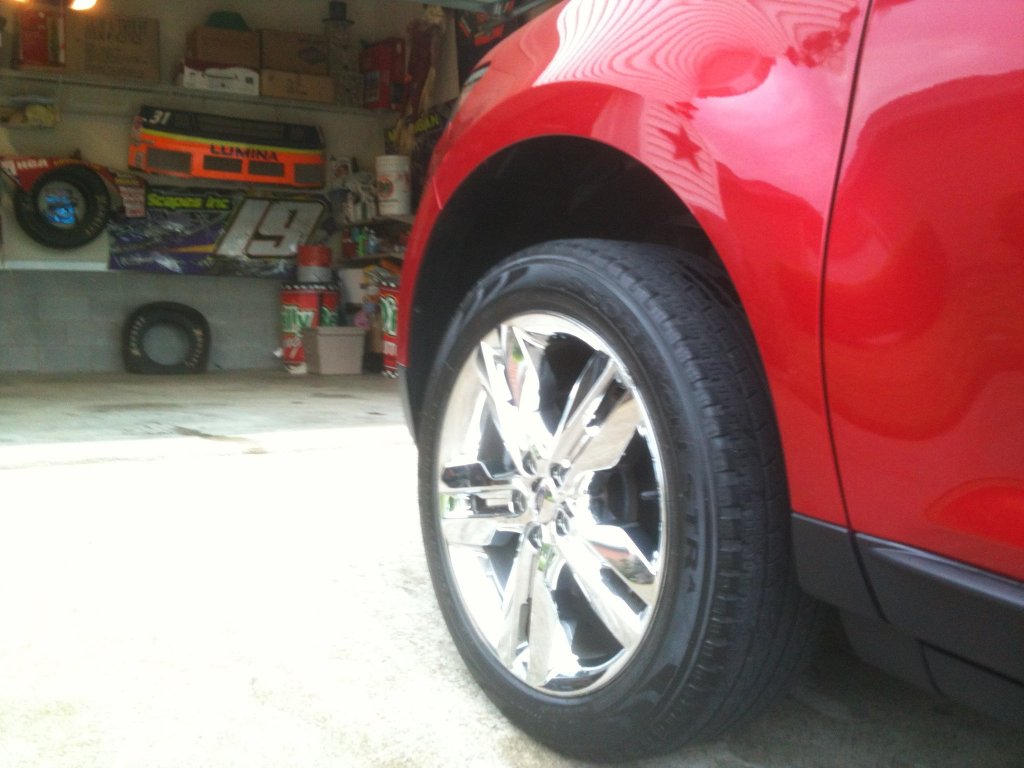

You sure have that part right! It could not have rained here for a month, but the day I wash the car, you can bet it will rain soon lol. I finally got the Edge cleaned up, man this thing is a 2 hour process to wash, dry, clean the inside and tire shine, but the paint is in great shape and I hate to start running it through the car washes and getting all the fine scratches on it. I really like how the wheels shine up, its hard to believe they're a factory wheel. Here's some pics, nothing you all haven't seen before, but its my first time posting them hehe. I'd like to add I'm enjoying reading the forums, there's a lot in information to be gained here, you all are great!
