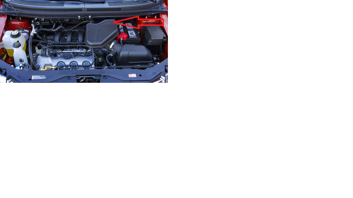

  5. The compressor does come on as well as the cooling fan. I will check my fluid levels this afternoon.

  8. I must have loaded it wrong..What purpose does the resonator serve?
