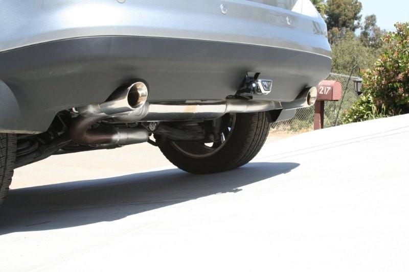

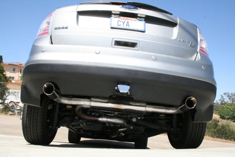

On my car I went to Express performance http://www.expressperformancecenter.com/xp...s_0108-001.html they bent and welded up a cat back system. the muffler is a stainess steel bullet. At first they also had the resonator up in the front under the rear set area. It may be visable in pic. I thought it was too quiet! So I went back and they took it out. Now the sound was perfect. That is how I have it today. 30,000 miles later it still sounds good. I spent 500.00 on the system. Since 1993 these guy's have done the exhaust on all my cars and trucks. Volvo's Gmc, Ford's etc. the Bullet Stainless muffler has a life time wty. here is a pic of my 2008 Ford F150 4x4 they put a System on in Jan of this year. It is a lot louder than my Edge System. The truck sounds Strong. -

I just logged in. It has been a good year at least. I have been on the F150 forum with my new truck. A year ago Last Jan. I bought my 2008 ford Edge AWD limited I added the Bullet exhaust sustem I also added the K&N insert but I removed the baffle on the side. Then I added the Evolution performance SCT x3 with custom tunes. I have 30.000 miles on my Ford EDGE with this setup. when I go to the dealer I put the tune back to stock. the car has much more power with my mods. when I first instlled the Exhaust, K&N, and SCT I took my car on the freeway It ran so strong 120 mph and it was still pulling strong. Other Edge owners that hear my car say it sounds good. Kinda like that of the Nissan 350 Z. It isn't extreemely loud like a honda civic. it is ral nice. the mufflers and resonators were removed and only the one muffler was installed see pics -

I went to wash my car and take photos. I then tried to post the photos and got an error. I then cut the picture size down and sent one - error!!! The exhaust was custom built not a bolt on. 3” system Center and a rear muffler two Tips all four parts were stainless steel w/ life time wty and then they made the rest of the pipe while I waited Bullet muffler is all that is on the invoice 287.70 My friend James said the back two mufflers are baffles the single front was the muffler. (original system) He showed me the system in the book. The illustration in the bullet parts guide showed a single rear muffler with One in and two out a straight flow glass pack type front muffler. James said the two rear muffler- baffle - ? Were real restricted James said that the muffler used was the same part # as used in Camaro systems. Single 3” in and out to two tail pipes I replied twice now and don't see it HMM
2008 ford edge Limited AWD I have 8400 mile about 1000 miles ago I added Exhaust and a k&n Filter My Power increased and my mileage increased. The noise level is perfect for me. I use flow master years ago but about 1999 I switched to Bullet Stainless steel systems on my cars. I owned a business next to this muffler shop. Flow master had failed the second time in three years no wty Bullet stainless was life time is the 1st reason for the switch. Second reason 150 - 250 for cat back systems. Ok so now I took my edge in and did the cat - back they installed strait through Res. for the frt and a single stainless in the rear coming out with two tail pipes. The tail pipes were dual wall stainless. The recommended Muffler for the Dynaflow system as it was called. The sound is like that of a 350z as posted with other systems. It isn't as loud as my f150 4.6v8 The noise level is perfect for my wife. I added the K&N air filter and removed the side baffle which is allowing good air flow. I have made an elbow forth air box to force air in as the side baffle only stuck out to the side. I couldn't find a good intake system avail as of yet. K&N said none yet and no est on prod. The edge now has a stronger top end, quicker take off. Throatier sound, better gas mileage So to me the change was worth the expense Just the sound improvement is worth the cost, at least for me. I like to hear my cars.
