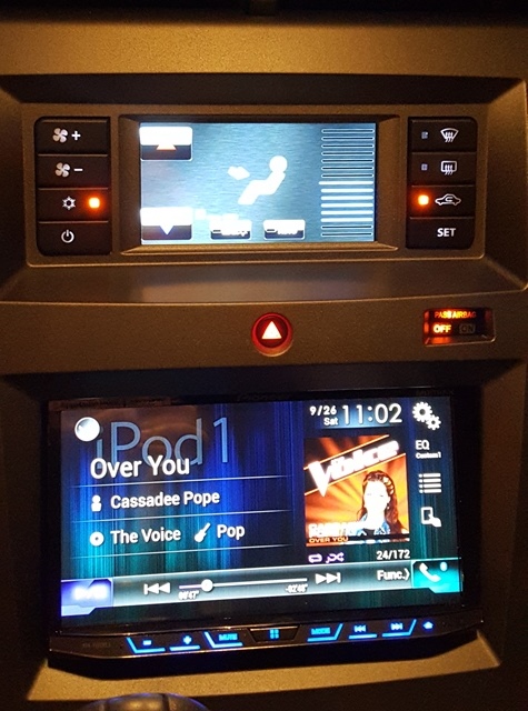

Here are some pics of the Scosche setup.
