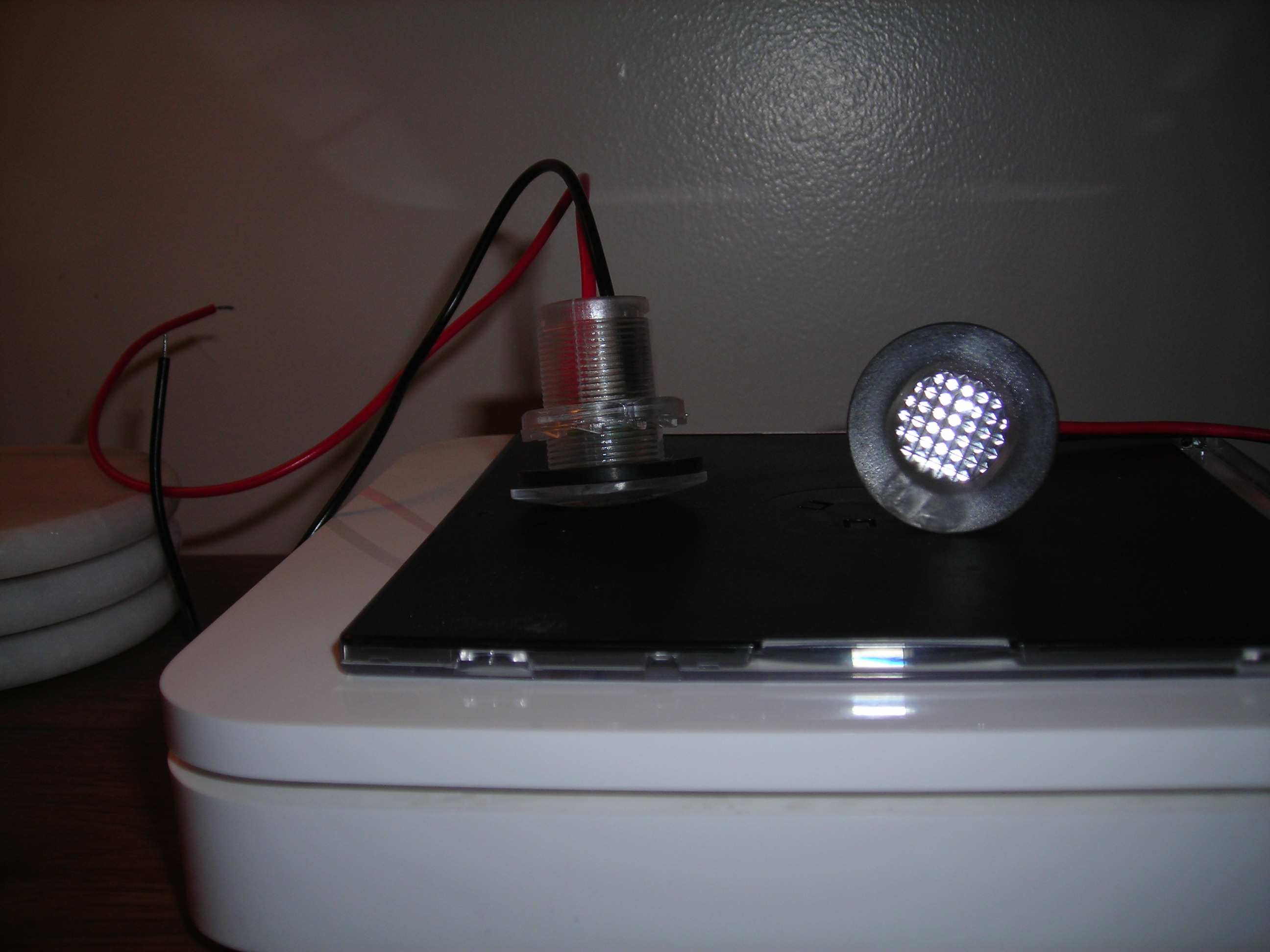

Update on installing puddle lamps on a vehicle that didn't come with them. There is no wire in the harness for the lamps if they weren't installed at the factory. So I have to improvise. I can connect a small relay to the wire that turns on the switch lights when the door is unlocked and I will use another small relay connected to the automatic door lock to trigger them off. This way they will come on when the doors are unlocked and turn off when the doors lock almost like the factory, I just need time to do it. I will take photos and have a diagram to wire the lights so anyone can do it if they wish.
Today I bought a wiring diagram on ebay so I'll even be able to do more crazy stuff.
I got the lamps from jagtradingonline on ebay. I just checked and he doesn't have any for sale at the moment. The total height of the lamp is 1 1/4" and the cutout for the hole will be 3/4" and I would not cut anything because it ruin the watertite seal.. I took off the mirror to check clearances, I don't think i'll have any issues there. I have replaced mirrors before its not hard if you tilt the mirror downward and have a long screwdriver to release to tabs. I will most likely have to run a wire, wouldn't be the first time. I just need to know where to run the wire from. I will use the existing harness connector and add a pin where the power mirror plugs in behind the oval black molding on the door. I was hoping they had run the wire into the door harness and all I would have to do was find it and tap it.
I picked some up on ebay. They are led live baitwell lamps. Paid $ 12.00 for them. They look just like the ones that came on my neighbors 07 Edge. I could tap into the mirror power however them they would be on all the time. Or, are they on whenever the headlight are on and if that's the case, ill tap into the power line that lights the switches.
I'm looking to install some puddle lamps. Does anyone know where I can tap the harness for power? I'm also installing leds in the interior door handles, I found the wire to tap in the door harness. I'll post pictures of the install.
