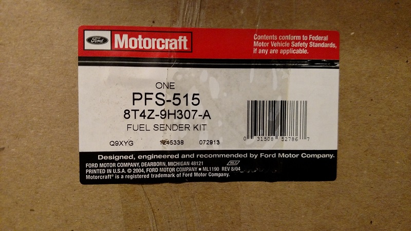

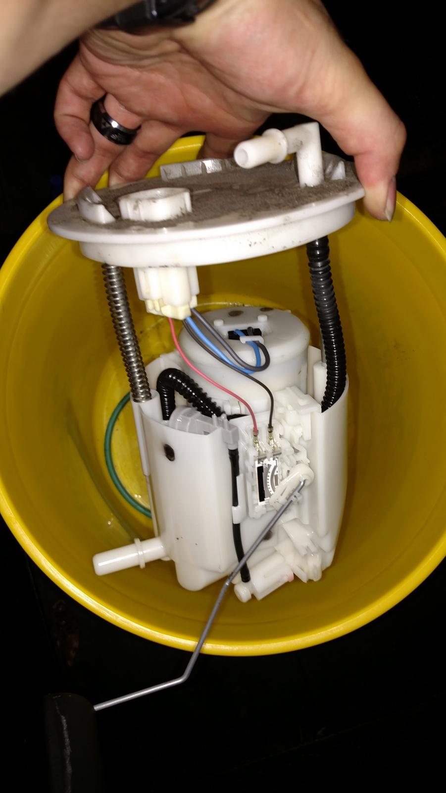

That's correct. The only fuel filter is a small filter on the bottom of the pump on the inside and it's permanently attached. Replacing the pump also replaces the filter. No in-line filter. -

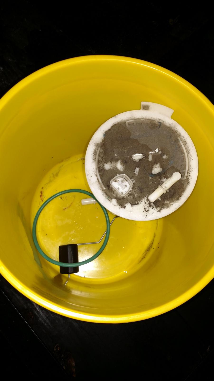

I have a story to tell as well as a how-to on an 09 Ford Edge Limited w/ AWD fuel pump assembly. This is my first post here but I wanted to be useful instead of whiny so here is my story lol. The Story I was driving my family out of state to a family reunion/Thanksgiving vacation. I was about an hour and a half from home on the interstate doing 75 mph when all of a sudden the edge went idle and lost power. The gas pedal was unresponsive and I pulled off the interstate as quickly as possible. On the side of the road the edge refused to respond to the gas pedal and it idled very rough. I could get it to slowly crawl forward if I held the gas pedal to the floor. I called a tow truck and they towed my car to a local ford dealer and dropped my family off at the car rental place. I got the rental, got all of our stuff out of the car at the dealer and continued my journey. The next day the dealer calls and tells me that they thought the problem was the throttle body sticking or failed but it turned out to be the fuel pump not operating properly. They informed me of a $1000 repair bill to fix this and I balked at it immediately (having done many fuel pumps in the past myself but on older vehicles) and told them heck no I’ll tow it back home when I get back. After towing it home with my truck and a car hauler I couldn’t find any how-to’s on how to replace the fuel pump. So because of this I winged it with little information and I come to find out this was the easiest fuel pump job I have ever done. So without further ado I will provide a text and picture how-to. Side note here, I didn’t think about making a how-to until I was almost done so I made as many pics as I could to make it easy to find and know what to look for. The rest is pretty straight forward if you’re at least a little mechanically inclined it shouldn't be hard at all. The How-To (Est. to complete: 1 hour) Step 1. Preparation First I released fuel pressure by removing the fuel pump fuse and letting the car run dry then I unplugged the battery in the car. I removed the rugs from the carpet in front of the rear seats and cleaned the area to help reduce trash and dirt from getting into the tank later. Step2. Gaining Access The fuel pump sits underneath an access cover plate located underneath the rear driver side seat. I removed the trim caps off the leg feet exposing the nut and bolt. Using a long breaker bar and an 18 mm socket I removed the bolt from the left seat leg and a nut/washer combo on the right leg. (Fig. 1) After that I just simply raised the seat up and used the seat belt to hold it up by yanking the seat belt to lock it in place. (Fig. 2) Next I carefully pulled the carpet up while being mindful not to catch the wires running through a slit in the carpet. After lifting the carpet up you’ll see a nice big tin colored access cover with 4 Philips head screws. (Fig. 3) Remove the cover and you’ll see the fuel pump and it will have a plug and a hose running to it. (Fig. 4 shows what the pump looks like from the top but it was after I had already removed it from the tank.) Just push a tab in on the plug to pull it off and push to tabs in on the hose quick disconnect and it will pop off. Now take a brass punch or a flat head screwdriver along with a rubber mallet or hammer and slowly work the lock ring off the top. NO SPARKS so be careful about this step. You now have full access to the fuel pump. Step 3. Removal and Install Blow off and wipe off any dust or dirt to keep it out of the tank. Now slowly pull the pump up and out of the tank. Be very careful and slow because the fuel pump is like a bucket and will hold gas, plus the fuel level arm will get in the way so you have to take the pump out at an angle and there’s also another hose attached to the bottom of the pump but I think this is an AWD specific thing and FWD models don’t have the 2nd hose but don’t quote me lol. (Fig. 5 shows what the pump looks like) Just pinch the 2 tabs and it comes right off. Tip the pump (bucket) to pour the remaining gas back into the tank. I had an actual bucket handy and put the old pump in it to keep gas from getting in the car. From this point on the install is just the reverse of the removal but I have a couple of key notes on the install. Key Notes on Install Remember to remove the old green gasket and replace it with a new fresh gasket ring. Don’t forget to attach the bottom hose before putting it in. Also when putting the lock ring back on there are little notches that align with a “bump” on the ring to indicate it’s fully locked. Make sure the line up before you put the access cover back on. When putting the seats back you can pull the legs out to make sure they clear the other seat to ensure there’s no catching and tearing of the seat fabric. The metal is quite sharp and it shaved a little skin off my finger during the process. Also make sure those bolts are nice and tight. It’s got to hold up in the event of a crash. I used a genuine Ford Motorcraft part for this replacement and I got it brand new for $170 with free shipping off of eBay. I have included a picture of the sticker from the box the part came in. The part number is PFS-515 or 8T4Z-9H307-A (Fig. 6) I hope this helps anyone who needs to replace a fuel pump or the fuel level sending unit. Thanks for reading my story and my how-to!
