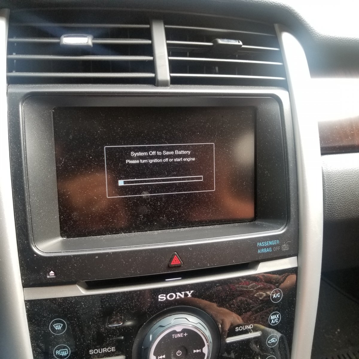

  1. Thanks guys. Well sure looks like the battery. Alternator is putting out 14.5v. Battery was 13.06, so I disconnected it. 1 hour later battery was down to 12.4, 2 hours later down to 11.8... all with no load. I'll replace the battery tomorrow... Thanks for the inputs.
  2. Thanks. I thought that could be the issue. 18 months seems like a really short life since the original was 6 years old, but you are right, things happen...
  3. I have a 2013 AWD Edge and I just started having issues with my battery draining when the car sits for more than a couple of days. Once I charge it up, I'm fine unless it sets unused for a few more days. I have checked for the obvious things like a light left on and can't see anything that might be causing it. The battery is only about 18 months old. I noticed a message on the screen when I shut the car off this morning that a warning "System Off to Save Battery - Please turn ignition off or start engine". Has anyone seen this or have any idea what might be causing it. Picture attached. Thanks
