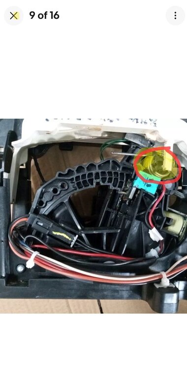

  1. No not really. But it gives the feedback to the fingers and the visual of the gear selection. I didnt realize my wife relied on this until it broke and she complained.
  2. Although transmission related. This is a haptic and visual feedback for the driver. Seems to be a common failure. In this picture the detent arm is broke off and missing. I got lucky and found another shifter two years ago and swapped that part. Recently that one broke again. I am guessing the age of the plastic is what fails. And they are fragile when the shifter module is being removed. Has anyone 3d printed a replacement ? Is there a repair kit? Can you bolt in a gen2 ( 2011) shift module?
