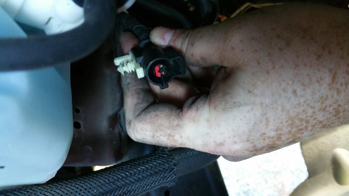

So my next question is, is it possible the dealer did something to damage it? The ABS, TC, and Power Train light have never been on on this vehicle aside from starting it up. It went to the dealer to do a full diagnostic. The day I drove it home the ABS, TC, and Power Train light started coming on intermittently and are now on permanently. The picture above is the passenger side and they did note in their diagnostic that the outer tie rod on that side as well as brakes/rotors need to be replaced.
Thats what I was thinking, but was unsure if that was a tone ring. So my next question is, is it possible the dealer did something to damage it? The ABS, TC, and Power Train light have never been on on this vehicle aside from starting it up. It went to the dealer to do a full diagnostic. The day I drove it home the ABS, TC, and Power Train light started coming on intermittently and are now on permanently. The picture above is the passenger side and they did note in their diagnostic that the outer tie rod on that side as well as brakes/rotors need to be replaced.
