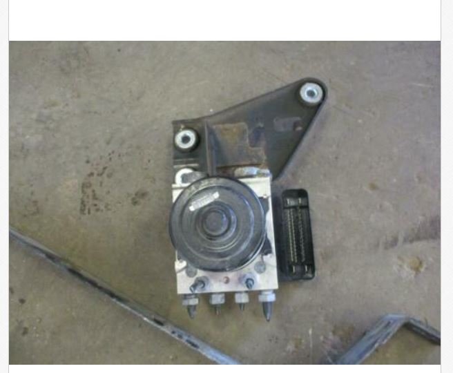

I did put in (2) masters and I think I did not need any masters in hind sight. The master were only 75 bucks. I got a used ABS unit with brain/HCU combo $70. I installed all - the 3 bolts on bracket - very difficult to get at. the (6) brakes lines are easy - the master cylinder is easy. I got a ABS code after install that I did not have before. (the brain needs reprogramming). So I pulled out and put my brain on used HCU unit and bled up top and then at each wheel. Had decent brake but soft. .
