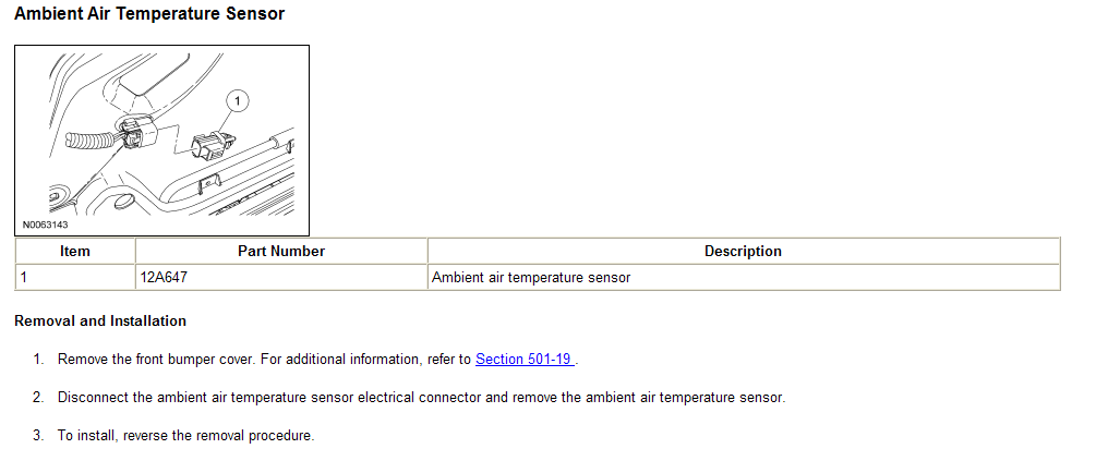

  2. I am also fighting my compressor not engaging. I still need to do some more troubleshooting but I am starting to feel mine might be PCM related. I already had my PCM replaced due to faulty coil packs. The Ambient Temperature sensor is behind the front bumper cover. Things might vary slightly as I have the 07 Manual. When taking off the front bumper don't forget to unplug the fog lights. See photos below.
