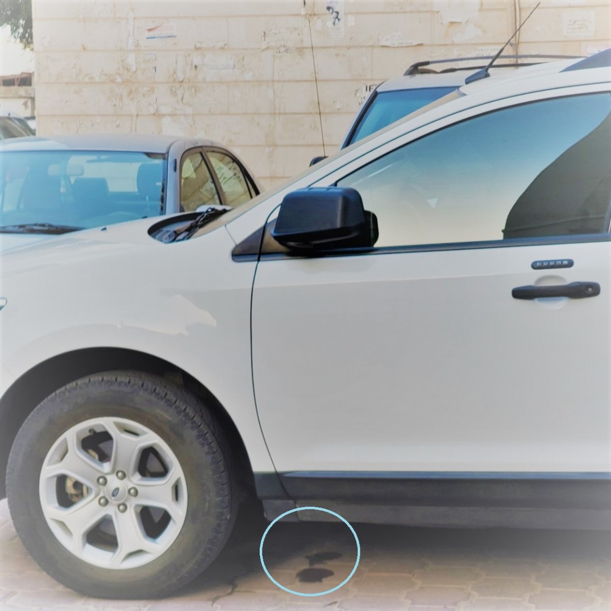

Hi, I noticed water dripping on driver side on the bottom of the car once i tuned off my ignition.. is this normal. BTW, while driving, i cannot see anyways.. i just spotted the water dripping after i came out of my edge. What could be the problem?
