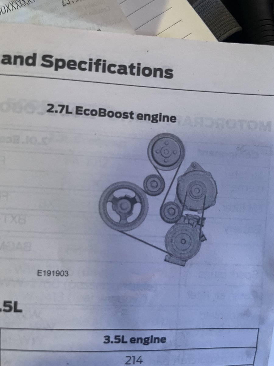

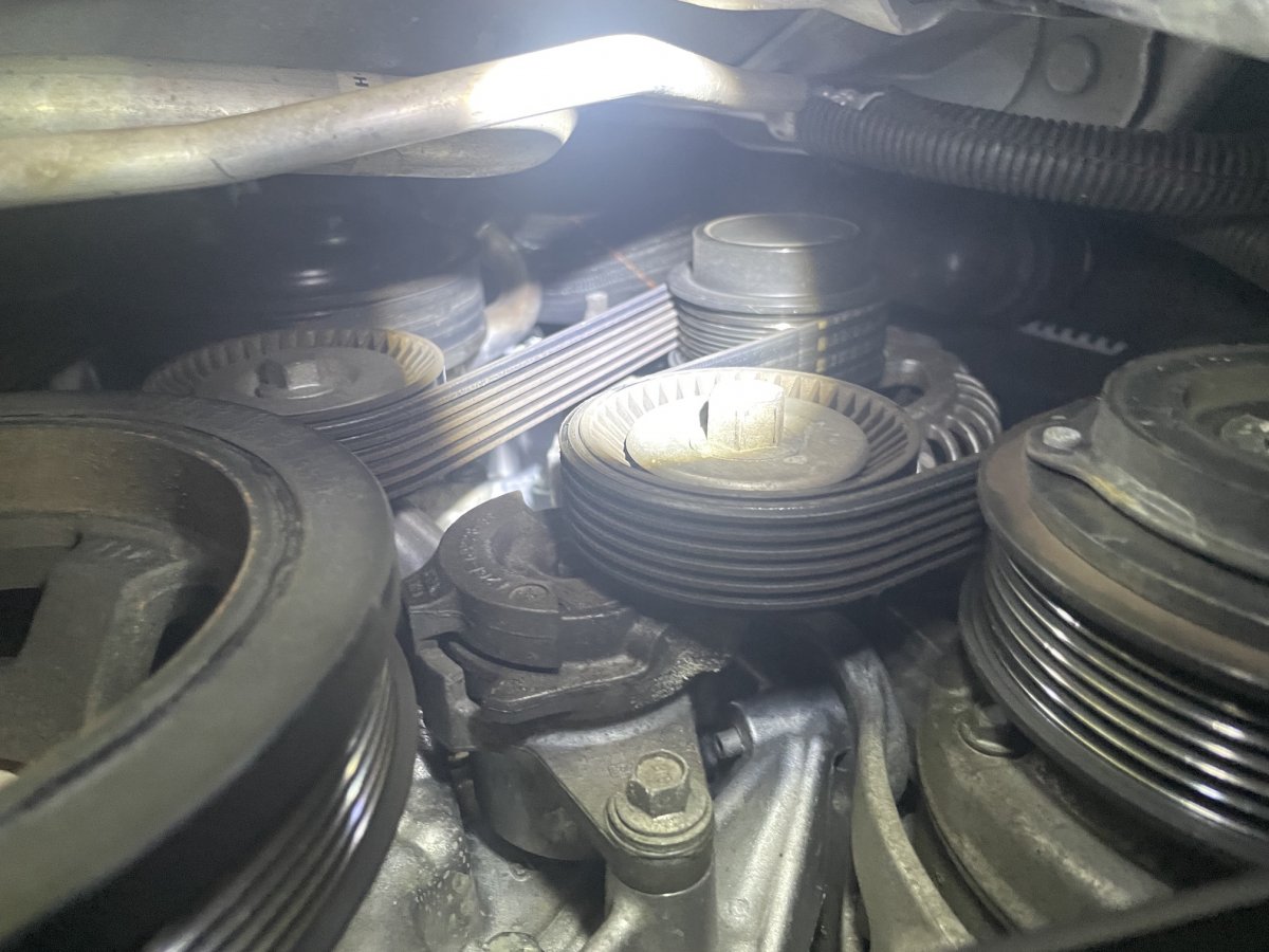

So this car belongs to a very good friend of mine. I was doing her a favor and swapping the belt. I asked what the vehicle was and she said '15 Ford Edge Sport. I look it up and sure enough 2.7l motor. I pick up the car and it's a sport, says so on the back. Order the belt for it. I spend a few hours thinking I'm insane. I've done a few serp belts and most times they're literally a five min job. This one was longer since you had to remove a tire and fender liner. Well this morning I give her a call and the convo went a little like this:
me: Hey I couldn't do it. You'll need to take it to a real mechanic. I tried for hours to make it work and I'm just stupid. However, the funny thing is that the belt is routed differently than what the manual says it should be.
