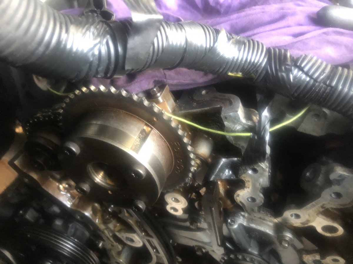

  3. Boss727
    2008 Edge, Timing Off on left side
    All lined up, Will report back after It’s buttoned up as my oil was a milkshake and Im sure people are doing as I was and googling 1000 words in different arrangements. Thanks for the responses, Marks are lined up. For everyone on google. Timing out of sync ford edge
  4. Boss727
    Alright, Thanks The T55 and was able to counter clock the small degree it needed. Pray for my valves. Thanks for the response.
  5. Boss727
    Backed 90 degrees of top dead center, but that only accounts for cylinder 1. Would pulling spark make the cam easier to line up?
  6. Boss727
    Am I safe to spin 300 degrees? If I try to torque it counter clock (chain off) Fear Im just going to take the bolt out. Thanks
  7. Boss727
    Hey guys, after much reading from you guys I dove in to replace my water pump after failure and 105xxx miles. Pump is in and upon reinstalling timing chain I found my intake? Or left side timing pulley to be off by about 3-4 links. Can not get the pulley to move by hand, If I put chain on to move the pulleys I will be left with the right side out. What can I do ???
