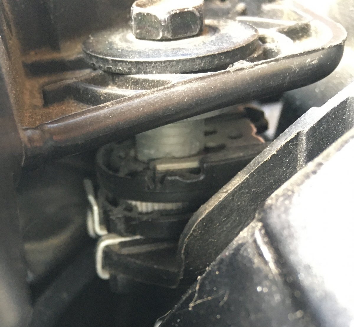

I've been searching for hours online and looking all over my salvage 2018 Ford Edge (2.0 EcoBoost), and I can't for the life of me find the AAT sensor. When I start the car it shows -40 for outside temp, but after driving for about 5 minutes is starts showing the correct temperature. Not a huge deal, but it's starting to get hot out and the AC won't work until the outside temp starts registering correctly. So, I pull the front bumper off and I'm following every connector I can find and I don't see the sensor anywhere. It's got to be there or else it would never register, but I have the haynes manual, and the Internet and I can't find it anywhere. I know what the sensor looks like... and it should be somewhere between the grille and the radiator I would think, but I'm stumped... it's a $6 fix that I've spent hours trying to run down
If anyone could send me a picture of it's location I'd be forever grateful!
