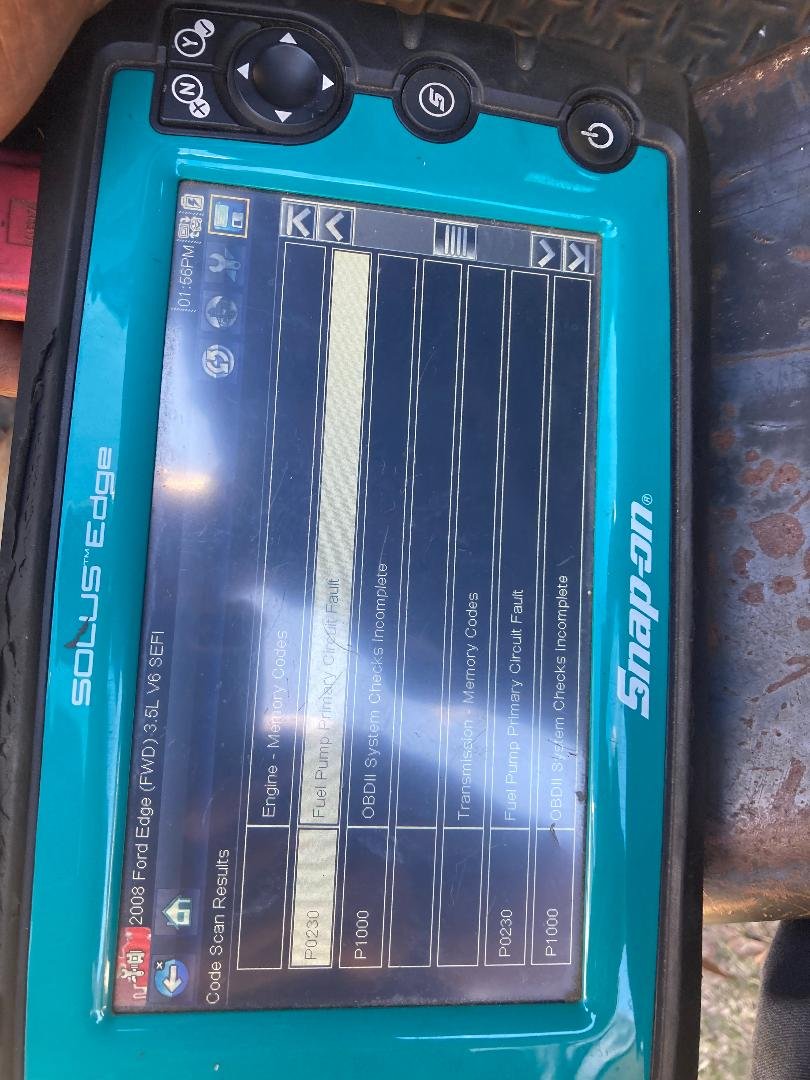

Yes I checked the fuel pump shut-off switch in the rear side panel, I replaced the diode and the fuel pump does not come on when the key is turned to on position. I will check for the proper signal to the fuel pump @ relay. I did hear a slight humming sound coming from the fuse box, but it went away.
I changed ECM and had it reprogrammed, but the car cranks but does not start. I changed coil packs, spark plugs, fuses, relays for the fuel system, and a new fuel pump. Its throwing P0230 code.
