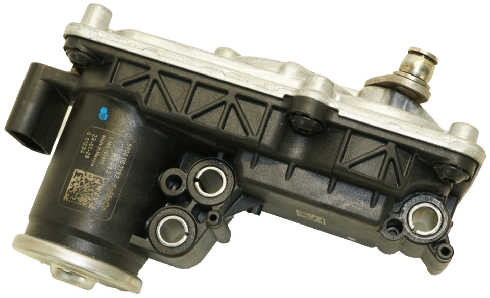

  1. Update! A month or so ago, I was passing some trucks on the freeway, on boost, when the boost went away, the 'wrench' light came on, and cruise control would not work. Got off the freeway, stopped for some coffee and on startup, the wrench went away, but the Check Engine Light (CEL) was on, and still no power or cruise control. Forscan was showing me two codes, P0243 and P0299. Both related to the turbocharger wastegate. Okay, back to Ford service who, on two previous visits, gave me the 'no codes, no problem' blowoff and said something to the tune of, 'It's running normally'. So now they acknowledge a problem with the 'wastegate solenoid', order a new part, and schedule the install. They wouldn't give me the old part, but said I could look at it in the parts department. So I did, and it did not look like any of the pictures I had seen of the vacuum based system everybody shows for the 2020 Edge. I was p*ssed they just pulled something off the shelf to make the idiot customer go away. But when I got home and looked under the car, sure enough there was a new version of the part they showed me at the dealer. An electric motor version that looks like the 'control solenoid' is built in. Researching that, it appears the wastegate controller on my engine is the same as that used on the 2021+ Lincoln Nautilus. The build date on my car is December 2020, and the Edge and Nautilus are (were) built on the same assembly line, so it makes some sense there might have been some parts sharing, especially since that was the Covid era. In the meantime, my brother, who bought an F-150 twin turbo brand new a few years back noticed some surging within a few days of taking delivery. He took it back and the service manager said, 'no codes no problem', but he also said to try premium fuel, regardless of Ford and the manual saying it could handle the 87 octane bilge water. He did that and the problem disappeared. I did that too. I am now running Tier 1 premium fuel, and with the wastegate fix, my car is running so good I am almost afraid to mention it, fearing I might jinx things. Everything is better, the engine is smoother, even the transmission and its' goofy shift points and lockup strategy seems happier. This is the car I was hoping for. Haven't checked the mileage yet. Wish I could say which one of the changes did the trick, but I was desperate and the timing worked out that two things got changed more or less at the same time. Next step is to scan things again myself to see if I can spot anything interesting. But for now, this thing sure is fun to drive. Good luck to you all

  3. Hello all, 2020 Edge 2.0 Ecoboost SEL AWD While passing some trucks on the freeway, on boost, the wrench light comes on. Stop for coffee, start back up and the wrench is gone, but the CEL is on. Back to the freeway, power way down, cruise control doesn't work. Finish my trip, go home and Forscan (using that to try and figure out the low speed surging issue, unsuccessfully so far) shows two codes: P0243 Supercharger Wastegate Actuator 'A' Status (-68) P0299 Turbo/Supercharger 'A' Underboost Condition Status (EB) In to the dealer, who said the problem was the 'wastegate solenoid'. It would be covered under the powertrain warranty. There was a two week wait for the part to come in. I asked if I could have the part after they installed the new one and was told 'No, we have to send the part back to Ford', but you can look at it in the parts department after the repair. While waiting, I tried to look up the part just to see what it looks like, how much an aftermarket part would have cost, etc. Everything I found showed a part that looks a lot like one of the hundreds of other sensors on this engine, with some vacuum hoses sticking out and an electrical connection. Okay, two weeks later I bring the car in, get a loaner, come back later that day, and ask to see the broken part. The lazy POS behind the parts counter started giving me a bunch of BS about having no way to find it, needed a number, blah blah. Another guy, sitting two chairs away, said he would handle it. In 60 seconds, he looked at the computer, got up and went straight to the shelves, and came back with a box and some parts: That, along with the arm that connects it to the wastegate and some nuts and/or bolts. At first I did not believe that was the part from my car, which led me to wonder whether they did anything at all, and just cleared out the codes in the PCM. But I climbed under the car and sure enough, I could (just barely) see a new version of that part on my engine. It appears my engine has parts from the 2021+ Lincoln Nautilus: Okay, whatever. So my car (original window sticker mentions a twin-scroll turbo) has a motor controlled wastegate rather that the vacuum operated one. The build date on my car is December 2020 (yeah I know, Covid car) and it was built on the same line as the Nautilus, so maybe it makes some sense it has some 2021 Lincoln parts on it. But now I'm left with more unanswered questions: Does the PCM in my Edge -know- it is controlling parts from a Nautilus? Is there special software for one or the other? Are the folks at Ford dealer service dept. up to the task of keeping track of all this? Could the mixup be causing the surging and/or schizo shifting issues? The only thing I know for sure is, if you have a modern car and don't have an extended warranty (a good one if there is such a thing), you are so screwed.
