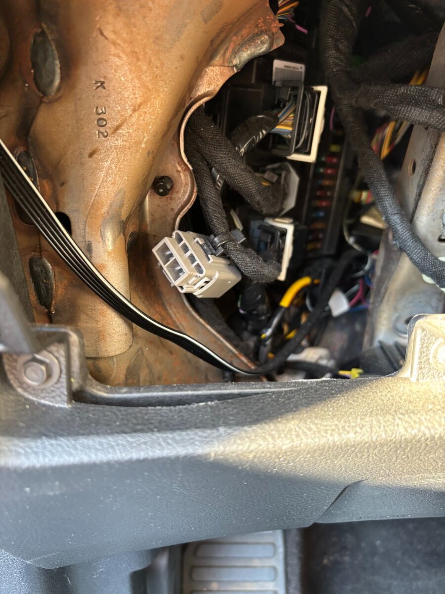

  3. I took it to a mechanic who replaced two fuses (which I could not reach myself) and that fixed the interior lighting problem. Thanks for the help.

  5. Here is a picture of the cabin fuse panel of my 2016 Ford Edge. It is taken from the opening in the dash after removing the small pullout tray. In the lower left of the picture is a multi-pin connector. Does anyone know what this connector is for? Maybe it is not in use because I don't have some optional electrical accessory. Could it be the connector for the interior lighting that somehow got disconnected? But from where? Along the right side in the dark area is the barely visible row of fuses that are essentially out of reach. Thanks. Paul in Texas
