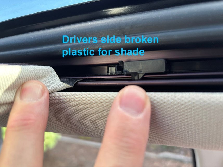

  1. Ford documents refer to it as a "Sunroof Cable" even though it's for the shade. There's a sku for the driver side and a different sku for the right. The sku for the left/driver side is FT4Z-58500B01-B. Tons of parts places online offer it for $130-250. Try your local dealer first, but mine wanted full retail. Open the shade and open the glass roof all the way first. You have to drop the headliner, which means you need to remove the A, B, and C pillar plastics, the overhead console, the seat belts, grab handles, and visors. That takes close to three hours. The screw covers for the visors are pretty much impossible to remove without breaking the one of the two tabs. The overhead console is more delicate than most people think, so be super careful with it (review youtube thoroughly for that one). You have to take special care to remove the C pillar plastics since one fastener is supposed to pull out of the metal body hole without pulling it off the plastic. You'll have to giggle it around a lot and pay attention to the slot shape to get it out, otherwise you'll break the plastic. Once the headliner is down, you'll have to unscrew one star bit screw on each side of the glass roof bracket (using a long shaft). There are two motors in the rear above the headliner. One is for the shade and the other is for the glass. Once you remove the three screws for the motor, one cable can be replaced in about 15 minutes. If you're considering a rear camera for your dashcam, this is a good time to run wire through the rubber conduit between the chassis and the tailgate.

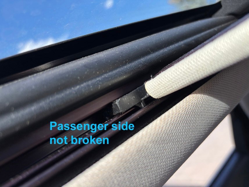

  2. The pictured plastic bracket for the sun shade broke. I'm told it's attached to a "sunroof cable." I see the search term you used in your duck duck go link is "how to replace ford edge sunroof shade" and while infinite results are displayed, none of them are actually for replacing this cable. If you can direct me to something specific relating to my issue, I'd appreciate it. New searches for "sunroof cable" do not reveal anything useful in or outside of this forum. The lack of info available on this leads me to believe it rarely breaks, or everyone lets the dealer fix it, or it's so easy to replace that nobody bothers mentioning it. It's looking like I'll need to drop the headliner, begin removing anything below the cable, and figure out how to get the new cable aligned with the other cable so they're in sync and don't pull the shade unevenly. I'll consider posting the fix in the forum once I'm done.

  5. This plastic bracket for the sun shade broke. Can anyone provide part numbers and instructions on how to replace? (There appear to be no topics already established for this issue. I've searched the forum manually by scrolling through the topics and by keyword searches in the sections for "Glass, Lenses, Lighting, Mirrors, Sunroof (BAMR), Wipers" and "2015+ Edge & MKX Generation II 2017-2018 Edge & MKX" and have only found topics about the glass and it's track. While I've not checked the dealership yet, I do not see parts available beyond 2014.)
