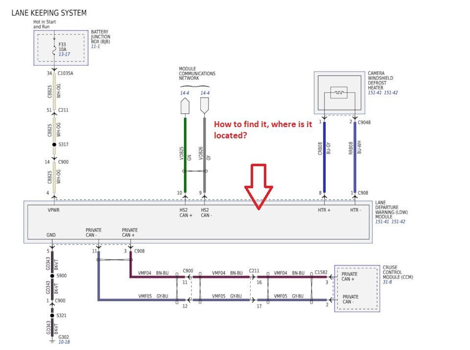

Iroga Posted December 10, 2025 Author Report Share Posted December 10, 2025 In section 151, figures 41 and 42, you can see the physical location of the connector for this C908 module. Can anyone help and post it here? 1 Quote Link to comment Share on other sites More sharing options...

Iroga Posted December 14, 2025 Author Report Share Posted December 14, 2025 Are there any 2019 Ford Edge rear defogger wiring diagrams? Quote Link to comment Share on other sites More sharing options...
