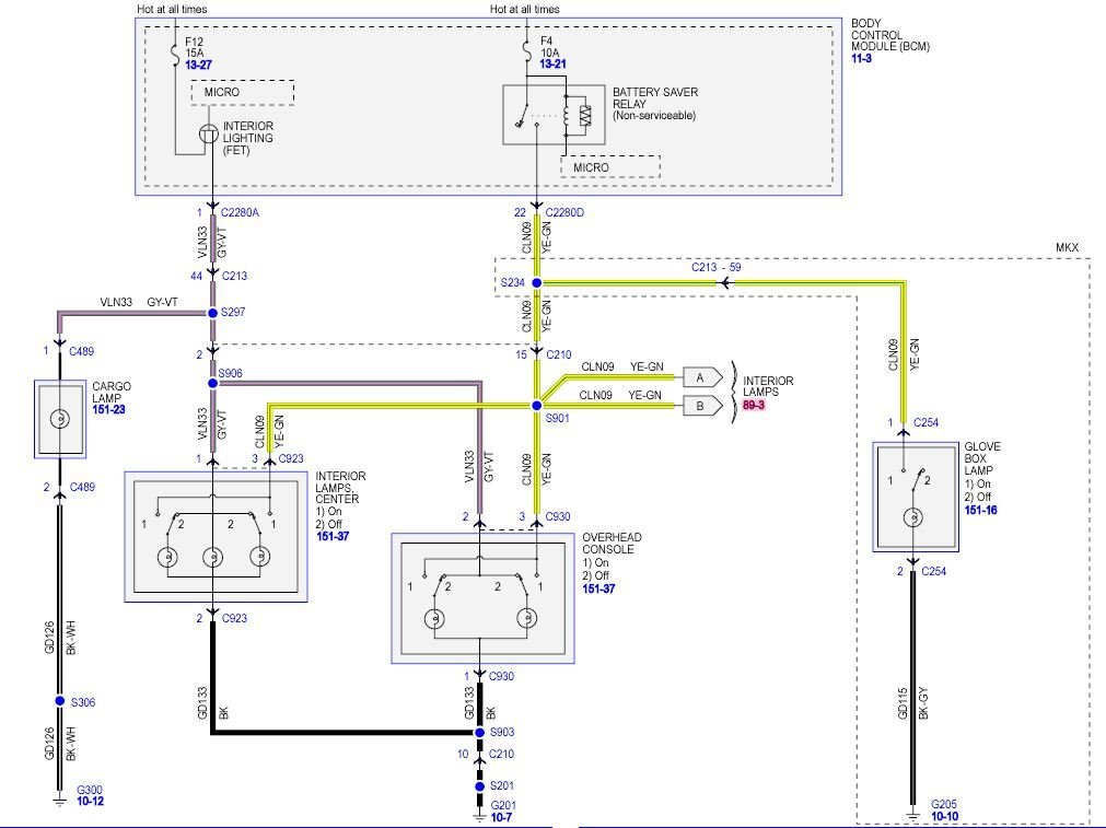

broke2011edge Posted 4 hours ago Report Share Posted 4 hours ago I need some electrical help. I just bought a 2011 Ford Edge and have been fixing some issues that I knew were present when I bought it (was hoping the electrical issue was going to be easier). One of the issues is the interior lights keep flashing on and off when the car is running. This is what I've found while troubleshooting while the car is on. With fuses 4 and 12 installed in the BCM, the lights on top of center console, the lights on top of the back seat and the cargo light flash. When I press the light switches on top of the center console, the lights remain on. The middle light on top of the back seats and the cargo light keep flashing and there is no light switch for those. With fuse 4 removed, the lights on top of the center console flash, when you press the on/off switches they turn off. The middle light on top of the back seats and the cargo lights keep flashing and there is no switch on them to see if they turn off or stay on. With fuse 12 removed, all the lights turn off. The center console lights can be turned on with no flashing when the on/off switches are pressed. The cargo light is off and there is no on/off switch. The back passenger's lights are off and can be turned on/off with the switches. None of the lights turn on when a door is opened. No error codes on the cluster about door ajar, but the back doors don't give a warning when they are open. The only warning light on the cluster is TPMS (already bought new sensors but haven't installed them yet) but I doubt that is the issue. I don't believe the issue is the battery saver relay since the issue is still there when I remove the fuse for it. I found the attached wiring diagram on the forum, but I need one with the door switches also. Anybody have any idea what can be or can point me in the right direction to continue troubleshooting? Also, is there any good place where I can get the diagrams? Thank you. Quote Link to comment Share on other sites More sharing options...
