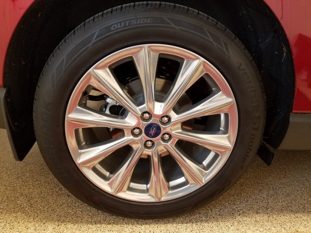

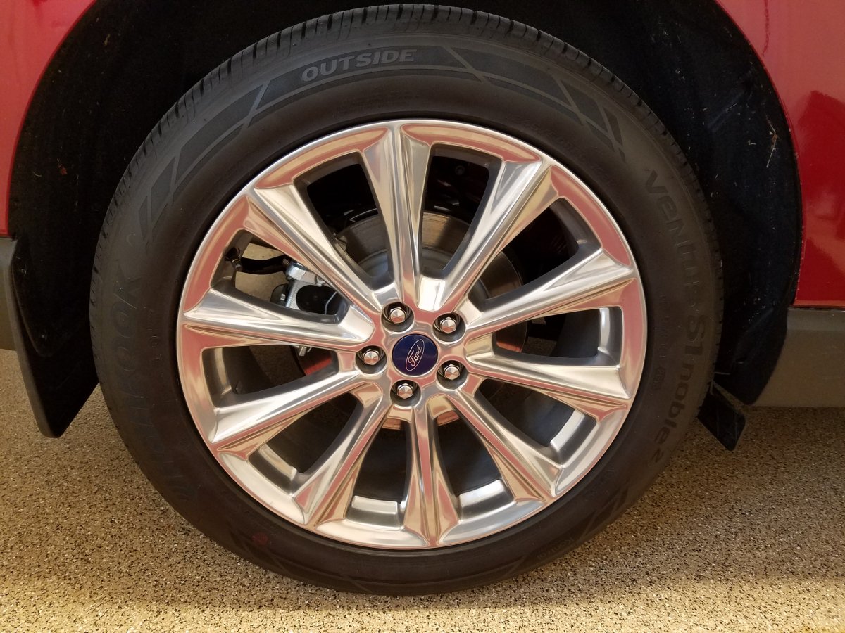

$600.00, 4 Hankook VENTUS S1 NOBLE2 - 245/50R20 Tires For Sale, New Car takeoff. These tires have 386 miles on them when taken off the car. Compare at $840.00 or more for the set. Located in Knoxville TN.
I just swapped my 20's with 18's, rides like a dream, quiet, and still handles nice. The only thing I am not sure about is do I need to have the dealer change the CPU to reflect the change in tire/rim size? The '20s seemed to be about an inch taller.

On my new 2018 Edge Titanium due to the horrible ride of the 20" rims with the 245/50R20 tires, I went to 18" rims with the stock size tires 245/60R18 tires. My question is it looks like the 20-inch setup was a little taller, do I need to have the dealer adjust the tire size in the CPU of the car? Please let me know.
