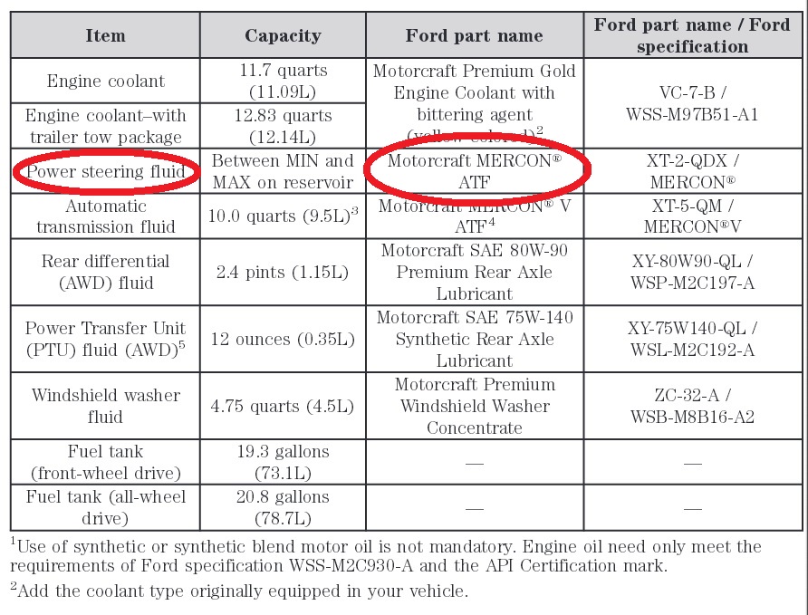

  5. --------------------------------------------------------------------- See now the manual I looked at said use Mercon, not Mercon V. I called Ford and they also said Merc V. The manual I got this info from is on Ford.com, you would think they would have current info.

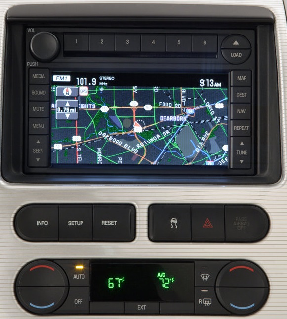

  9. We just picked up an '07 Edge SEL, the speakers sound terrible (to me) so I am looking at upgrading. I have a few questions about Ohm loads and speaker configuration etc. We have Nav and a factory subwoofer, pic of our model radio attached. 1) How do you identify whether you have the premium or standard system without pulling the door panels or other disassembly (wondering if I have the dual drivers per door)? 2) What are the factory door speakers resistances (2ohm, 3ohm, 4ohm)? 3) What are the door speaker dimensions (diam & depth)? 4) To add a subwoofer amp do I need to bypass the factory subwoofer amp and if so is there a simple plug & play harness? 5) What is the factory subwoofers resistance? 6) What is the internal depth of the factory subwoofer enclosure? 7) What is the internal volume of the factory subwoofer enclosure? Thanks for the help
