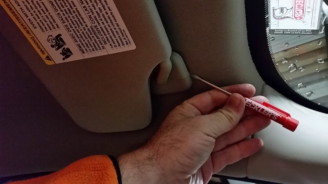

First I removed the trim around the drivers sunvisor mount.
This is pressure fit around the top of the mount and requires an outward motion to free the trim.
After removing the trim, remove the two T-15 Torx screws that hold the sunvisor.

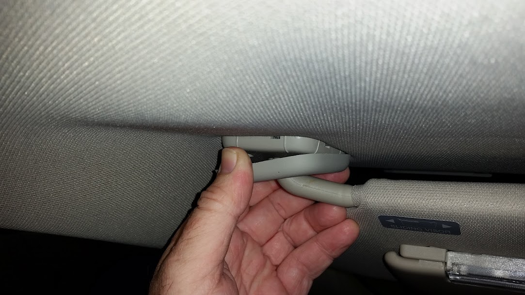

Loosen the A-pillar trim by pulling inwards to free the clip.
Loosen the headliner around the drivers door by genly pulling down on the weather stripping and working the headliner out.

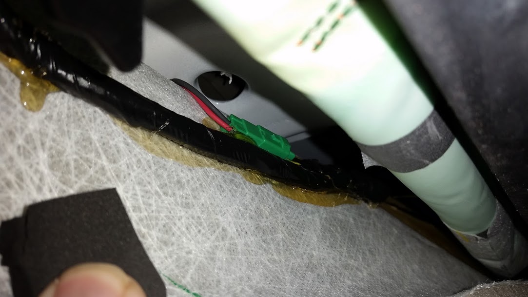

The vanity mirror power connection is located just aft of the headliner / A-pillar joint.
You need to gain access to the small green connector.
The green connector is tacked to the headliner with an adhesive.
A little gentle work by hand or small tooling will free it from its grip.
The green connector has a locking tab - don't just try to pull the connector apart.
My vanity mirror simply snapped off.

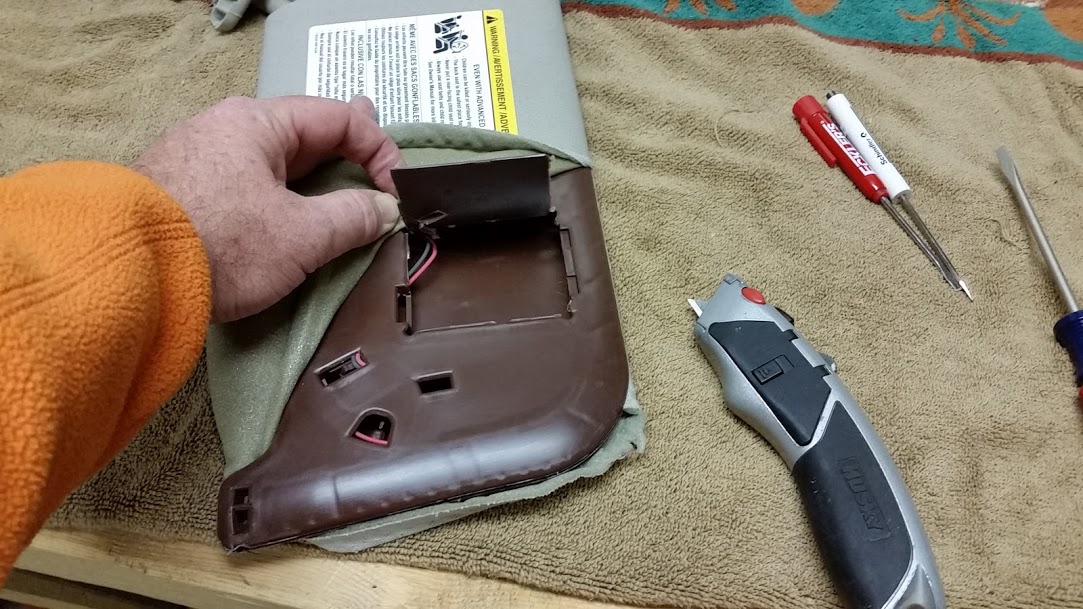

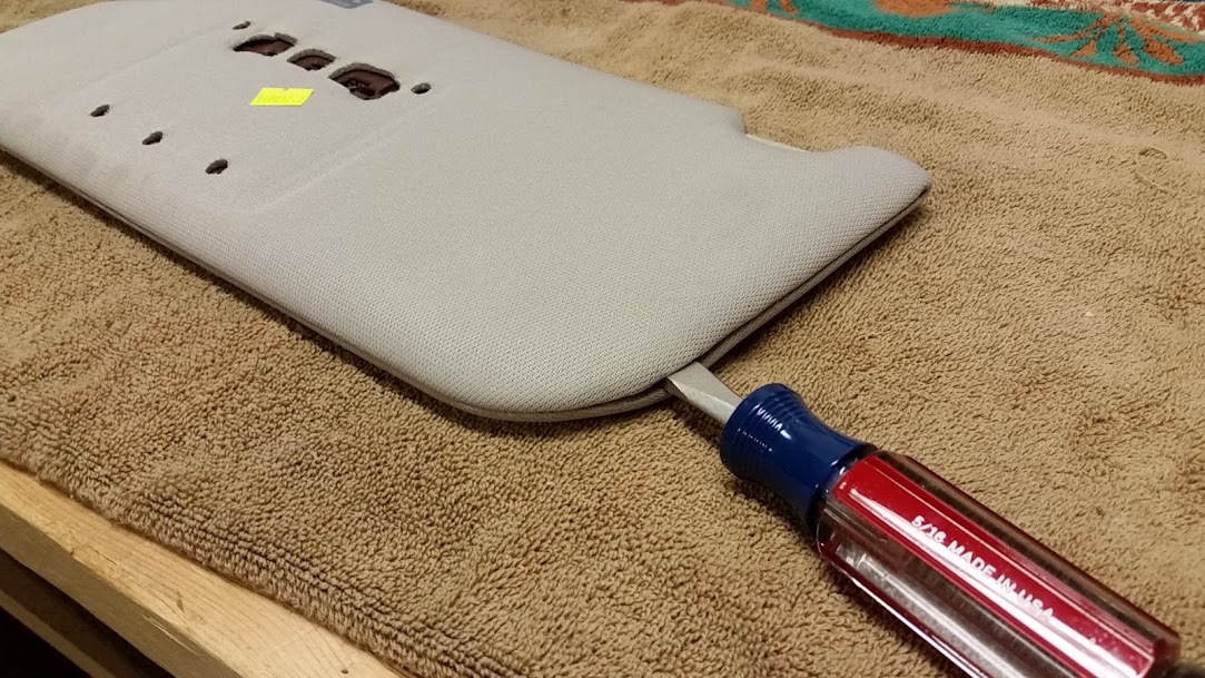

I used a wide-blade screwdriver to open the end of the sunvisor to gain access to the sunvisor covering.
The covering is held into place by plastic teeth from each side of the sunvisor housing.
Seperate the housing and gently work out the sunvisor covering.
Pull the covering back enough to gain access to the location where the Homelink is installed.

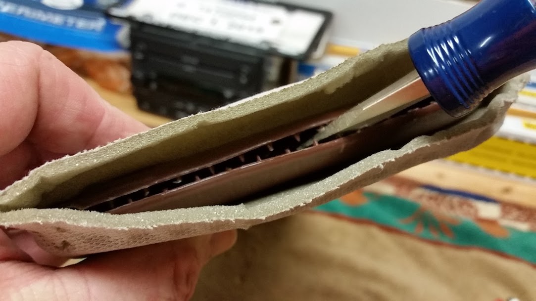

I used a razor knife to cut the sunvisor housing.
Dont cut it too wide - cut along the thin section of material around the "plug" for the Homelink.
I removed the cover and button assembly (flexible rubber) from the Homelink.
I plugged in the power and ground wires into the white power connector.
This was simply a matter of pushing the wires into the plug.
The plug has metal tabs much like a wire tap to add a wire to an existing circuit.
I fit the Homelink into the opening, leaving the small tabs on top of the sunvisor housing.

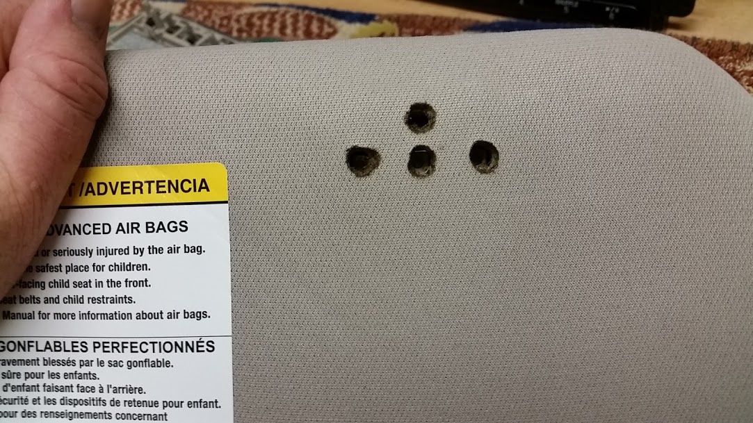

I used a soldering iron to make the holes for the three buttons and, the indicator light.

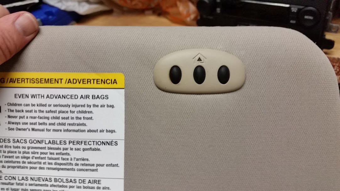

I then laid in the button assembly and pressed the cover onto the Homelink.
Reinstall the sunvisor.

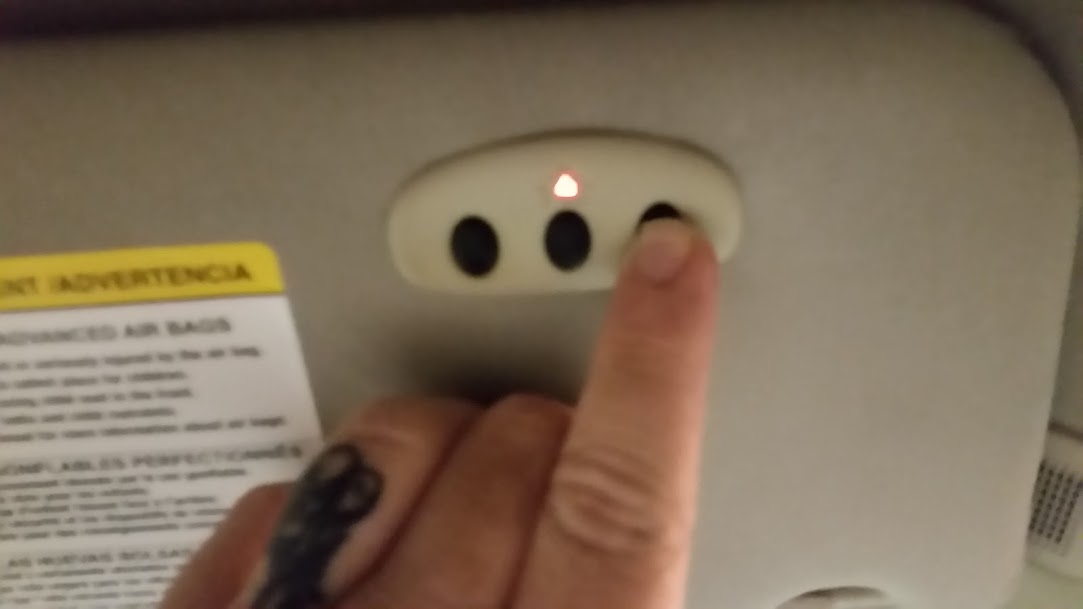

Don't forget to hook up the green power connector.
Test - Program and, Enjoy.
