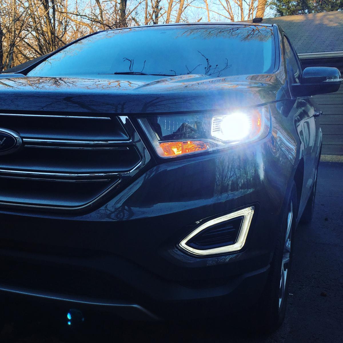

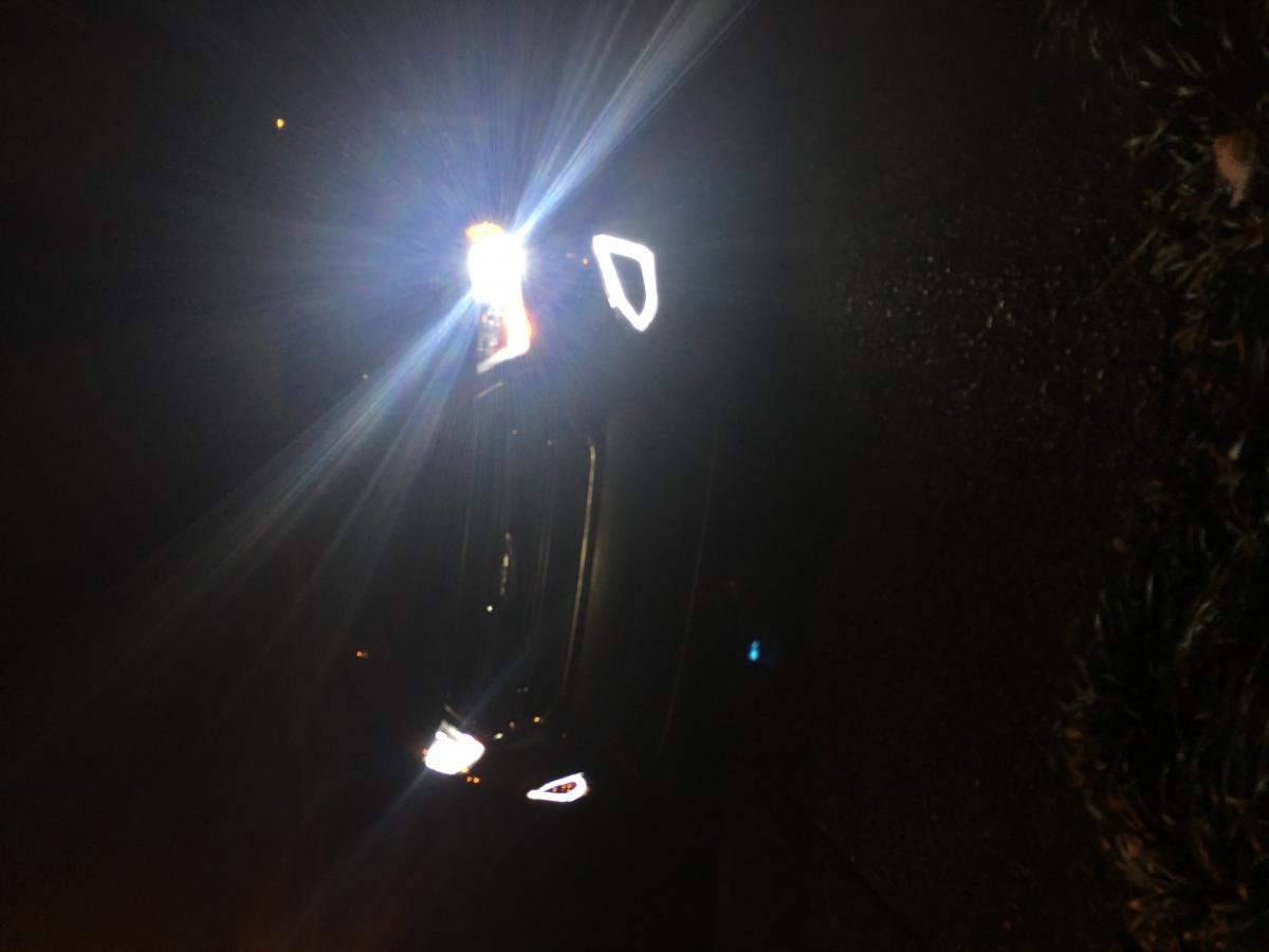

Going Back to the original question, based on my experience(15 titanium).... HID kit to replace halogen (which i believe all SEL have ) do not work great unless you install them with a relay that draws power from the battery, as the onboard computer thinks the bulb is "burned" out since it draws less power (this is what i was told). Once installed with the relay, the lights work OK but not perfect. The "Auto" mode will still cause a conflict which is resolved by switching them to ON then back to AUTO etc... all of this is assuming you have DLR, wouldn't know otherwise...
