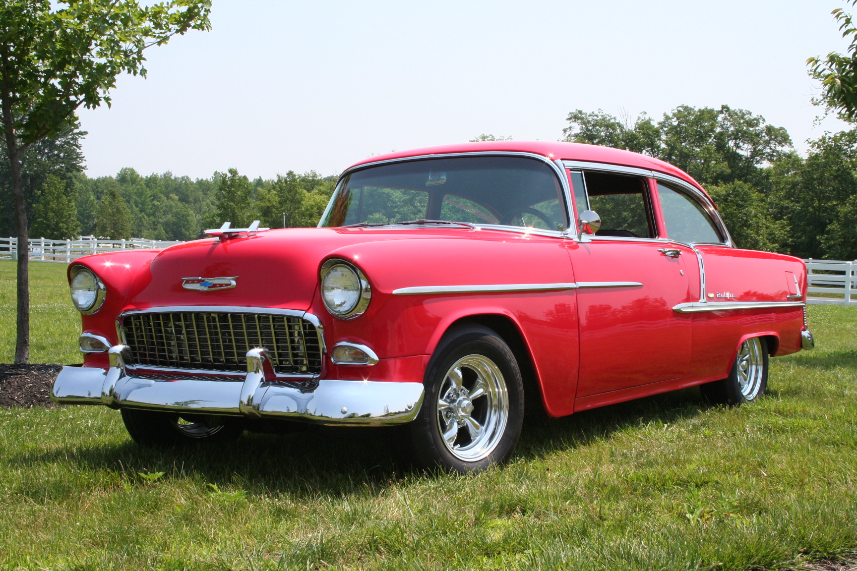

  1. I have to get rid of these factory "upgraded" 20" wheels - show me what you got! Anyone seen an Edge w/ Shelby Torq Thrust M?? I kind of like the old school muscle car wheels.
