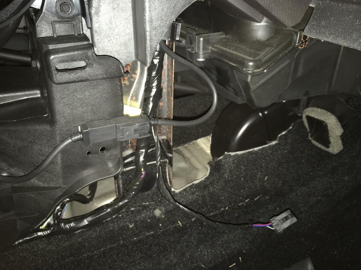

  4. It's not about airbags but the airbag module or restraint module. I found it, it can be accessed through the right console panel, not needed to be removed entirely, just the front part. I have attached a pic, maybe it will help someone else.
  5. Does anybody know exactly how to get to the module? Do I need to remove just the side panels, do I have to remove the center console entirely?
