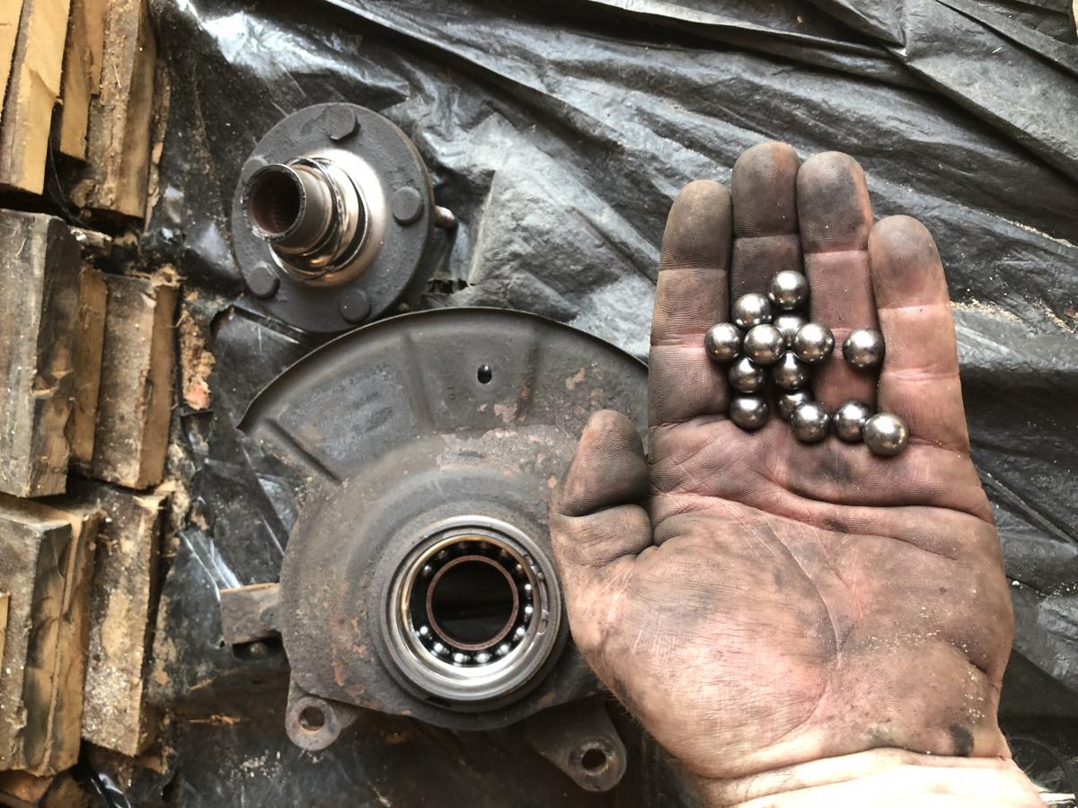

It turns out that the spindle nut was incredibly loose. Im not sure if the bearing was damaged or not. As of right now, Im going to retighten it to torque, and then check for play in the wheel again. I may not have to replace that bearing.

For about a week, my 2010 Edge has been making a fast clunking noise when I turn the wheel left. And kind of a metal on metal noise when Im driving. I put it up on the jack and the wheel has a ridiculous (dangerous) amount of play. The tie rod ends arent moving, and neither are the ball joints. I replace the wheel bearing last year, when I put the new engine in. Also, my brakes have been really soft. Heres a link to video that I took of the hub. Let me know what you think.

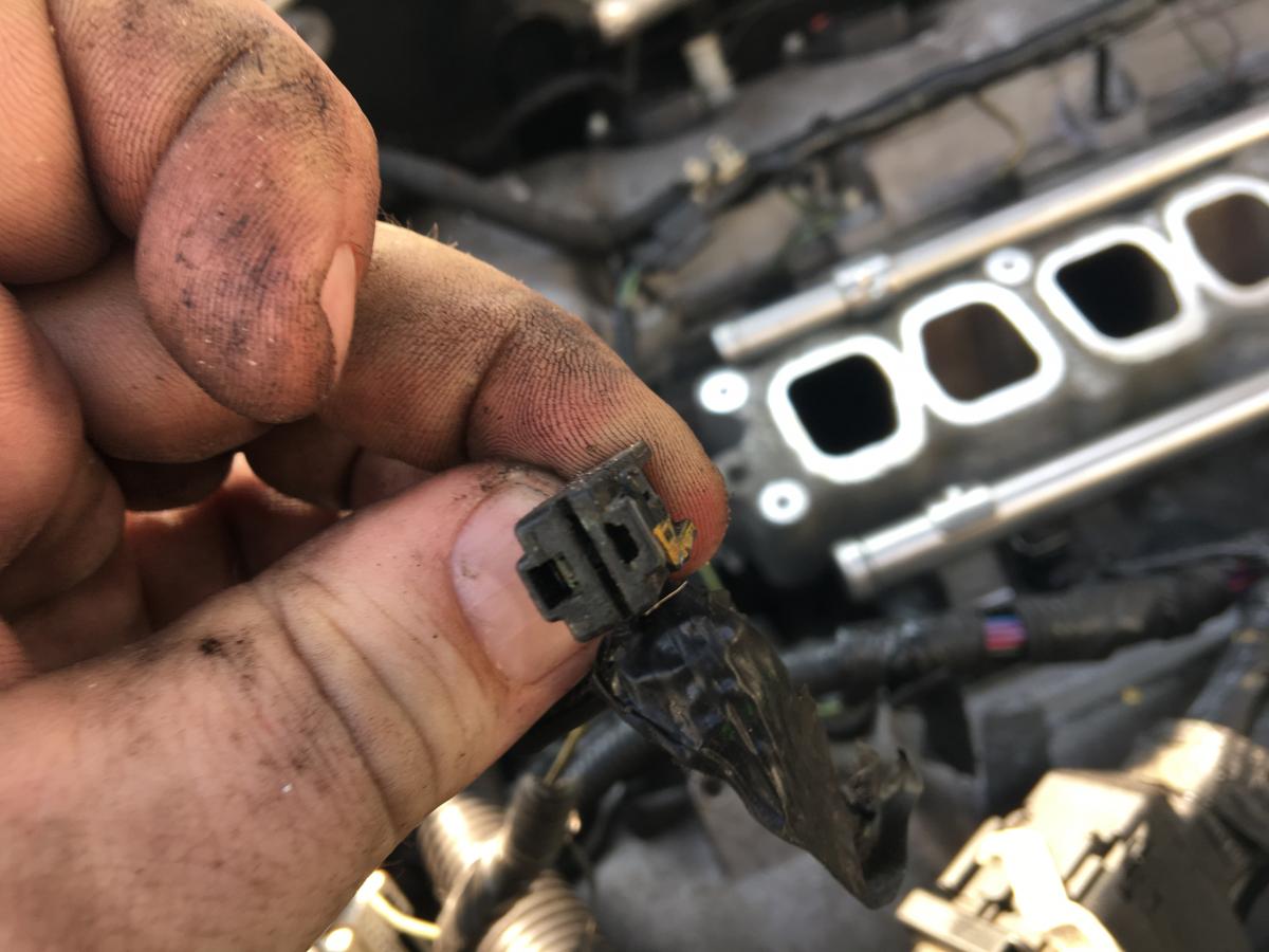

That green wire connector is a power steering pressure connector. My Ford dealership has a catalog with all connections broken down by the amount of wires, and has pics. Now to get it plugged in.
I Googled that, and it doesn't appear to be that connector. It doesn't have any markings at all, except for the word "push." That leads me to think that maybe it's something aftermarket, like maybe something for the remote starter.
Mac, you were 100% right. I found it in less than 10 seconds. I love your videos, by the way.
Never mind. I get what you're saying. I think you may be right. I'll check on it first thing in the morning.
So you believe that I've got it upside down? It's very possible.
