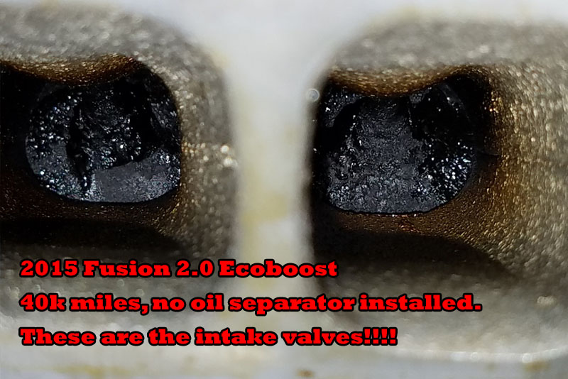

  2. Not a 2.7EB motor but a Ford Ecoboost motor at that, just recently did a separator setup for this 2015 Fusion 2.0 EB(direct injected), 40k miles. To get to the PCV valve you have to remove the intake manifold, which allowed us to inspect the intake valves... Think a catch can is worth it here? The can's may not stop this completely from happening, but it'll slow the process down.
