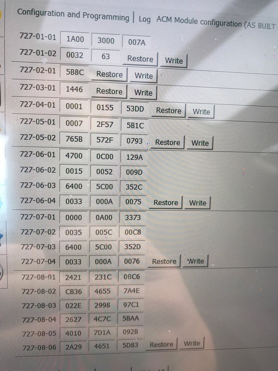

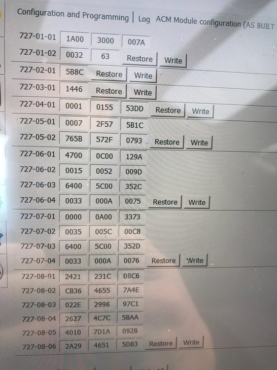

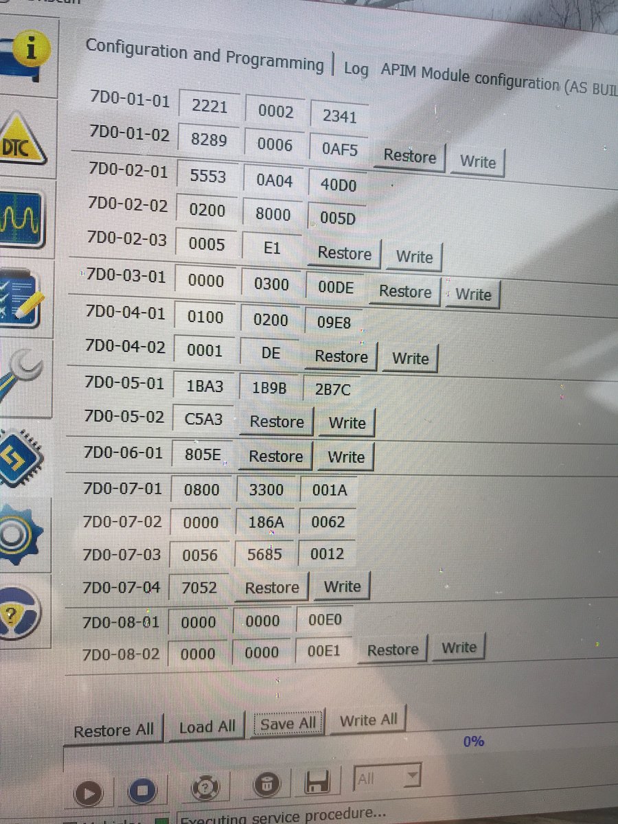

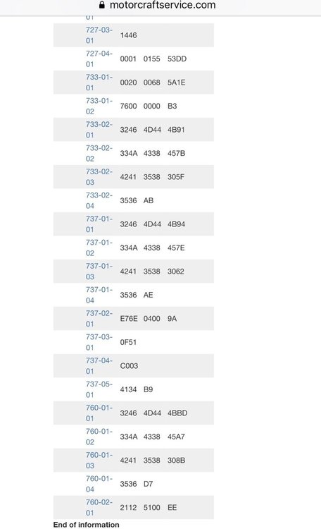

  4. @toast1850 I have only changed APIM and ACM settings, so I’ve just taken a picture from my asbuilt from ford. If you want to check with yours to make sure you have the original settings, you can enter your vin at https://www.motorcraftservice.com/AsBuilt But here is mine as well:
  5. Okay @Tim Mallon here is my apim and acm. I don’t think the acm should affect it, unless possibly if you upgraded your acm too? My ACM is non-Sony and only door speakers, so you I’d you have Sony, I probably wouldn’t change the ACM according to mine. Let me know if this works for you! Also, do you have push to start or keyed start? Mine is keyed.

  7. Sure, I’ll double check when I’m home, but I think I was able to use toast’s verbatim. Are you having a similar problem?

  10. I actually have recently discovered something that will really improve the sound if you have replaced the speakers. If you are familiar with forscan (if not, easy to learn and do), there is a single code change for the amplifier (called the acme for now on) to disable the equalizer and REALLY improve the stock sound. In the “as built” code for forscan in your vehicle, you’ll want to change the value for this line: 727-01-02 x*xx-zz where * represents the number to change, change it to a 0. It will get rid of the heavy and muddy processing and output a cleaner sound. That coupled with my previous instructions has made my 2014 Ford Edge SEL (non-Sony)have a HEAVENLY sound, where initially it was honestly VERY disappointing. Hope this helps! If you haven’t used forscan, it’s easy to use and there are lots of instructions to use it, but you need a special OBD2 cable and a computer to connect to your vehicle.
