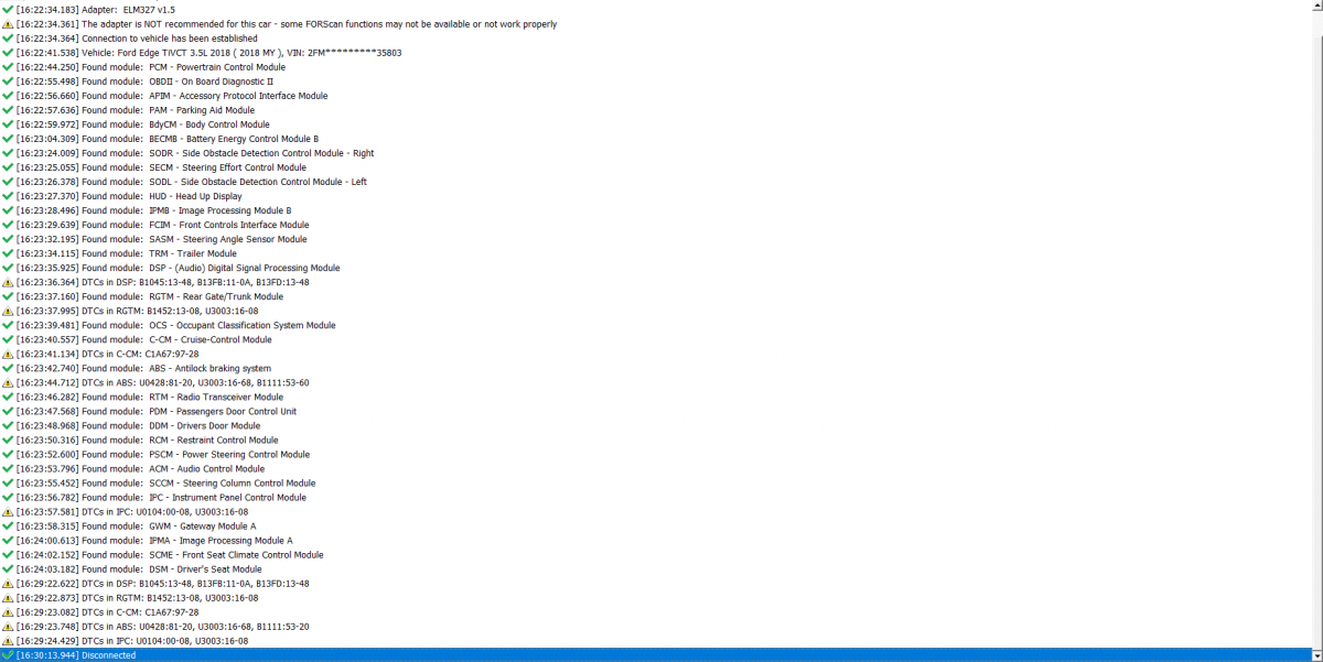

  1. I couldn't really check all the connectors because of the power liftgate issue I'm having also, as some of the connections are near the spare tire. I figured I would tackle this 1st, then on to the B1452:13-08 and U3003:16-08 codes I'm getting from the RGTM. But I'll fight that battle another day. Thanks for your help, Al
  2. It's Working! Thank you Haz and dabangtsa. After a little more research, I found this seems to be a recurring problem with these ACM's. For under $70, I decided to take a gamble and picked one up on eBay. Haz was correct, it was model FT4T19C107HE. Took about 20 minutes to swap, and BINGO! I've got music again! Thanks again for all your help. Al
  3. Here's what came up with Forscan:

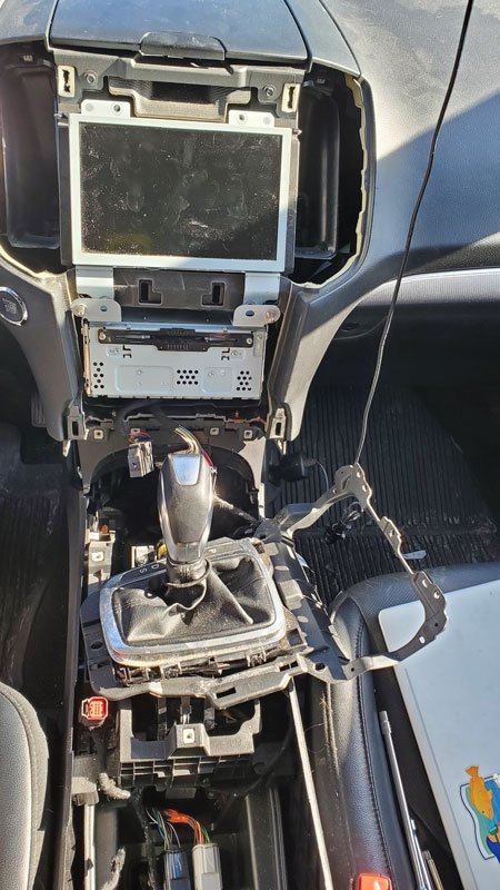

  6. My wifes 2018 Edge Titanium AWD with Sync 3 navigation lost all of the audio recently. Nav functions seem to all work, only no audio. After doing some research, I am under the impression the ACM is faulty. I've tried disconnecting the battery for 20 minutes, doing a soft reset and a hard reset. Still no sound. Looking on eBay, I see there are a few models (FT4T-19C107-KA, FT4T-19C107-KB, FT4T-19C107-KC, FT4T-19C107-KD) available for this vehicle, most for $50-$80. Before I take the dash apart to find my exact ACM model number, is there a way to find the ACM model with just the VIN? (2FMPK4K87JBC35803) Any help would be greatly appreciated, Al
