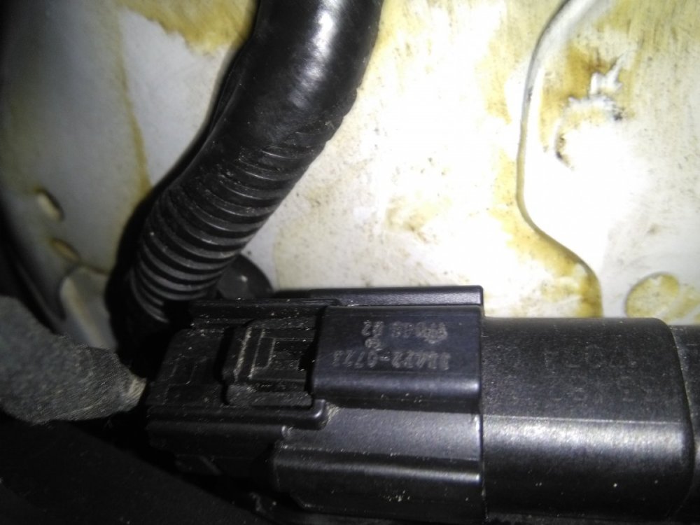

Need help finding what part this wire connects to
ThugFordEdge3.5 replied to ThugFordEdge3.5's topic in 3.5L
Sorry I took so long to get back. I guess it's completely normal. I'm assuming it may be a junction connector. Or at least that's what I found on another forum discussing that wire. I had gotten the code on that black plastic harness 33472-0723 And then did a Google search, and only one discussion about the wire came up, along with the actual harness connector plug for sale at a few sites. Here is the link to a Ford fusion forum that discussed this exact wire plug http://www.2gfusions.net/showthread.php?tid=9060&pid=145646 -

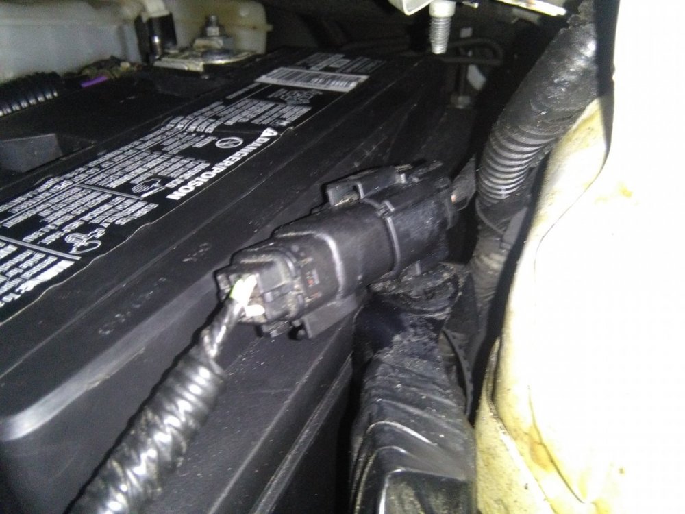

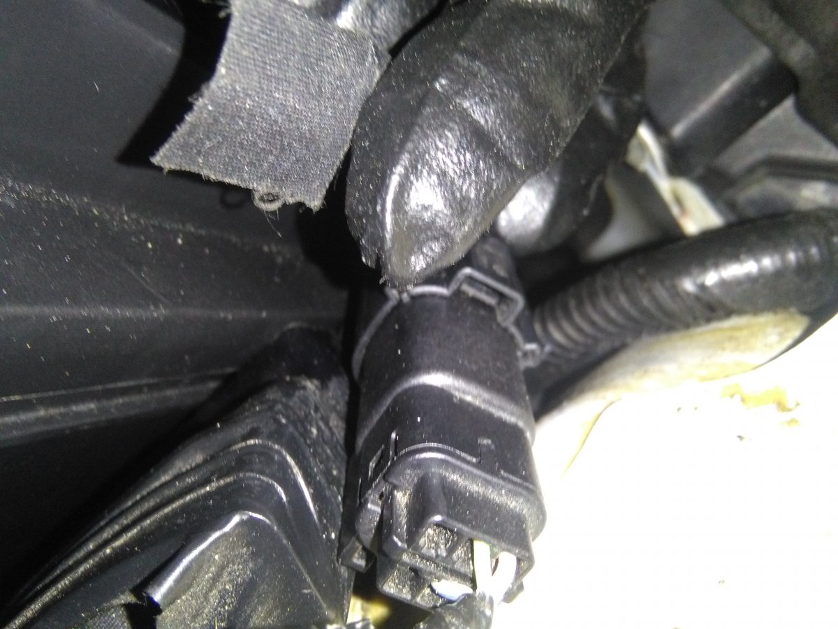

Where can obtain the wiring of that location? I think the whole situation got much more serious when I reached back there and all the wires in that taped up area are cut. I been getting some strange behavior from one of the dealerships. I called and spoke to manager about the vehicle taking a long time to warm up, and that was a month ago. Before finding these wires I felt like they where afraid to deal with my vehicle or go near it. It's been 30 days of excuses and told this and that. Also they where the ones who replaced my rear main seal. So I think those wires may have something to do with it. Somehow I'm not getting any Codes from it, so if these wires are important. Then whoever did the cutting, did it intentionally because they also did something else to block these codes. I'm hoping I'm wrong, but I don't think 3 to 5 wires just randomly go in Ford edges and connect to nothing lol -

I tried that, nothing happened. Just strange to have wire not connected, but also no codes from it. I would think something would have been noticable by now. I do have the engine taking a long time to warm up when it's cold and winter, and this symptom goes away in the summer. So I've ordered a motorcraft coolant temperature sensor, Stant SuperStat Thermostat with gasket. Also ordered motorcraft cylinder head temperature sensor. I got intake manifold gasket already for when I remove the intake manifold. The coolant temperature sensor is faulty for sure. Just the other day I noticed this sediment at the bottom of the degas bottle, and I ended up flushing the coolant, but there is still some in there. So I plan on draining the coolant and removing all the parts and leaving thermostat out and going nuts on flushing using zerex super radiator cleaner, and then I'll use Thermocure and flush using hose for a while before running 80 liters of distilled water. I'm hoping to take care of this issue that's been around for 9 months. I went to 3 different Ford dealerships, and they couldn't come up with anything. I bought a diagnostic scanner and found the faulty coolant temperature sensor, and right after I found the coolant system full of sediments that is dry like chalk when I rub between fingers. Now I'm just hoping to figure out what that wire is. After all this I'm never bringing my vehicle to a Ford dealership again. I been chasing problems for 15 months. New one with each visit to Ford lol. -

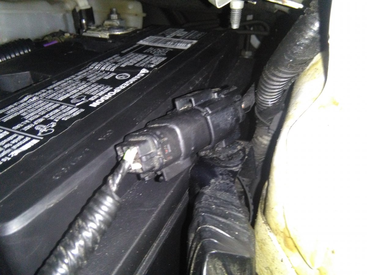

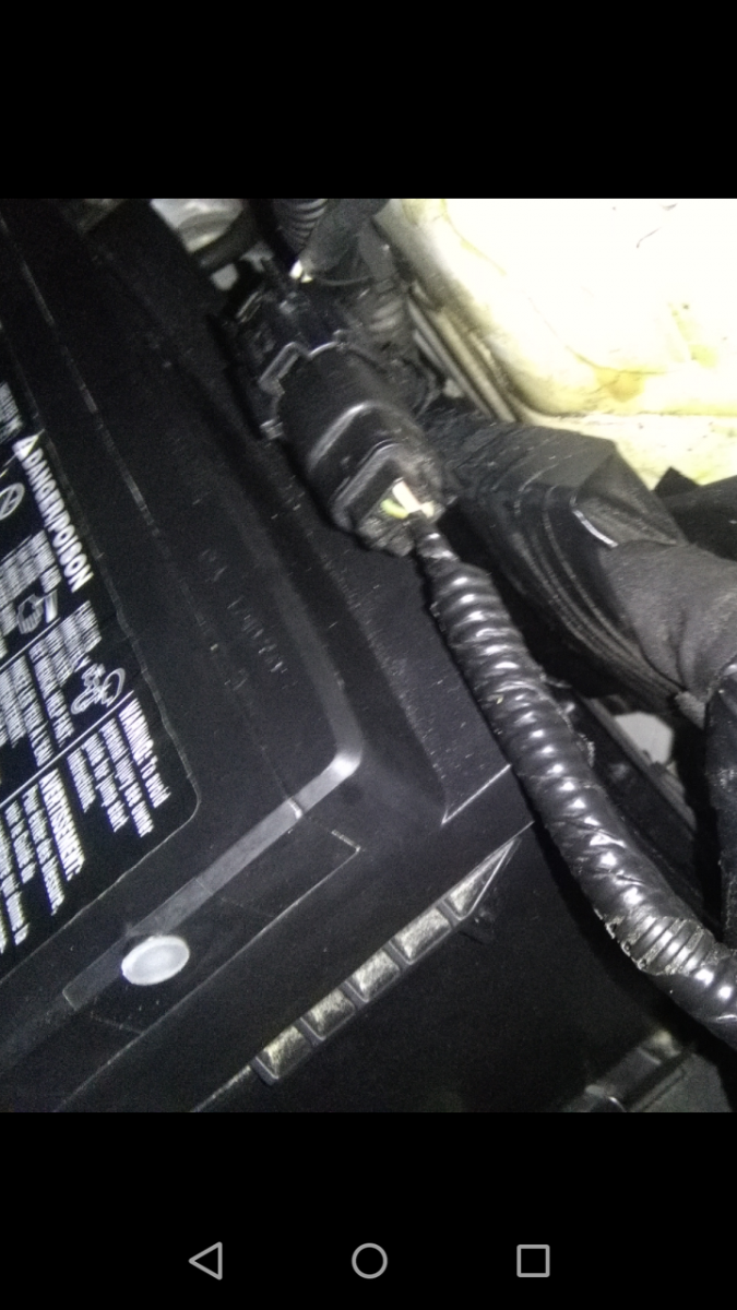

I have a 2017 Ford Edge Titanium AWD 3.5L V6. I was looking around under the hood the other day, and I noticed right between the battery, and the metal frame this 3 inch taped up wire with connector harness plugged in to another wire harness connector. It also is held in place by a push in type clip that holds it neatly in place. I've been able to find a picture of another edge. Not even the 3.5l V6 and I could see the plastic harness, but I couldn't make out anything else from the picture. So this wire seems common enough, and I was hoping someone will know what it connects to. I'll add pictures below. Also I should mention I had the rear main seal replaced a few months ago, and transmission was removed for this. So it could very well be some sensor connecting to the transmission, or one of the sensors around the drivers side of the engine. Any help would be greatly appreciated. Thank you.
