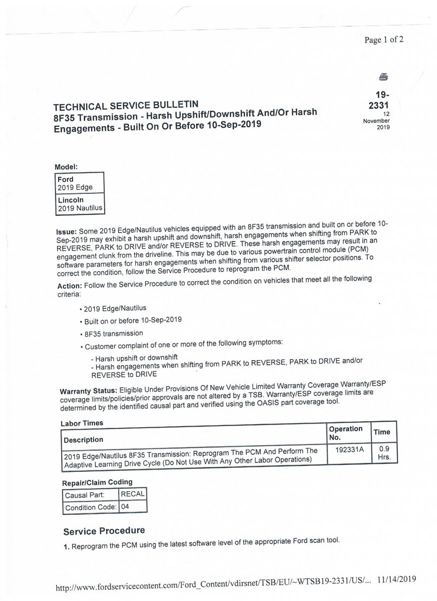

  9. Johnny B
    2019 Edge Low Speed Surge/Buck
    Toby 99; I had the 19-2331 performed on my vehicle over a month ago. It did not help the shifting issues at all. I was told that it is for another problem with the same transmission ( a harsh engagement clunk when shifting from park to drive or drive to reverse). I would be very interested in knowing what Fords' field service engineer had to say. I too tried the cruise control behind another vehicle in traffic and noticed the same thing that you guys have. A much smoother acceleration and shifting. Please keep me informed of any new developments about this situation.

  11. Johnny B
    This is the TSB that came out yesterday. (TSB 19-2331) it is for a different problem with the same transmission. I had it performed on my vehicle today, didn't seem to help the low-speed shifting problem. The service manager did show me where he contacted Ford to let them know they need to look into the problem.
