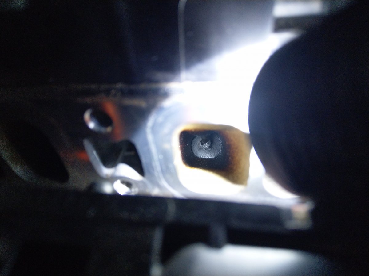

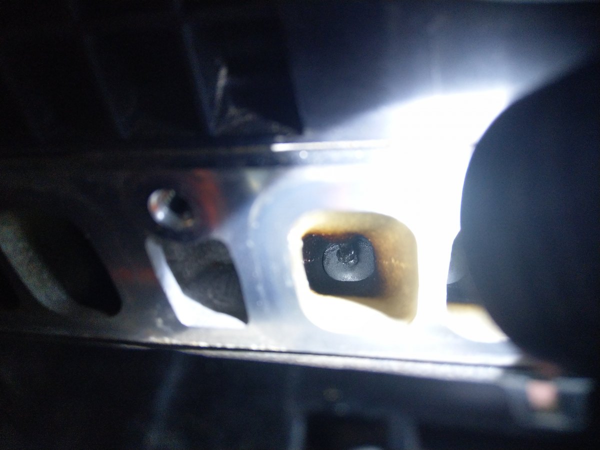

    3

    I have a 2018 with 44k miles. Just bought it and put a catch can on today. This was the condition of the valves when I popped the intake off. I put some CRC Intake Valve and Turbo Cleaner down the intake when it was closed, letting the stuff soften the buildup. Then I sucked it out with a plastic straw modded to a shop-vac. Lotta gunk came off of em. We just traded in a 2014 Escape with the 1.6 EB and it had developed a rough idle. I'm guessing that at 189k miles it was all sorts of plugged up.
