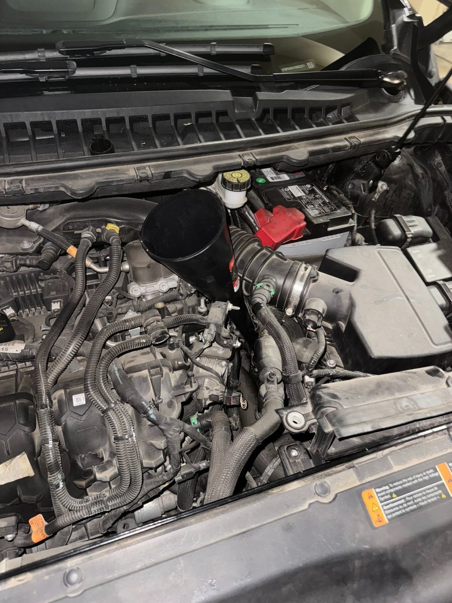

  6. When I’ve done it no more than .2qts, it’s all about how much you filled it in the first place. If you see nothing at all that usually means it’s too low. I like the strategy of seeing what came out, matching it, then starting the engine and cycling through the gears hanging out for 5-10 seconds in each one while cold (this can be done with the air filter box off in a garage free of debris, but that is risky. I recommend inserting a long funnel first then reassemble the air box before starting). Then leaving the engine running in park, I remove the level plug and add fluid until the more comes out the side. I’ve found that while cold trying to match what I drained still leaves me low by up to .8qts. Once I verify that, I put the plug back in and assemble it to the point of a test drive to get up to temp. Since the fluid expands with heat, filling it until fluid comes out cold will guarantee that it’s not under filled for what can be a 20 minute test drive.

  8. Just wanted to share an update on this post. Once you have done this before and have taken out the flow restrictor on the 8f35, this job can be done much simpler. I was able to get the cap off and fit the funnel in with the airbox still attached. I loosened the 2 mounting screws and popped it loose while trying to free up any other slack I could and it moved just enough to jam a long funnel. I also found that with some careful positioning, it is possible to take off the leveling plug without removing the tire, though it is a tight fit and the wheel should be turned all the way to the right. This made the job take effectively 30 minutes start to finish, but it does require knowledge of where these parts are already located and an ability to reach these places with objects in the way. I have seen Ford Techs say it is alright to run the car a bit with the airbox off so long as you keep the are very clean, so that is an option if a funnel can't fit (though this does come with risks of course and keeping the airbox on will always be safer).
