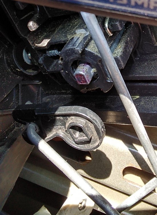

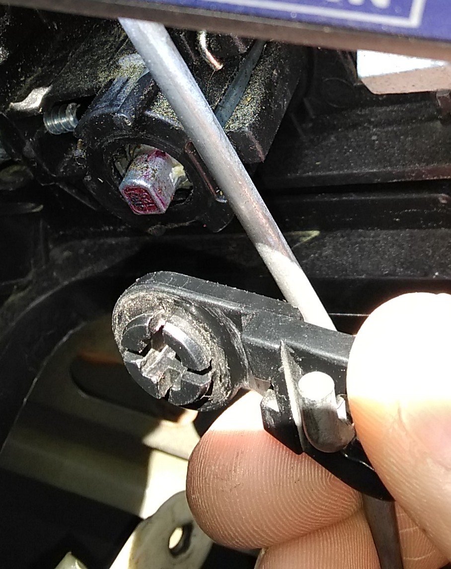

Got the manual lock working today. No clips missing, no damage to the handle base. You can see in the first pic, when it's facing the wrong direction, it appears as if it should accept an oh-sh!t clip. But I guess a better mind than mine would have known better. The lock cylinder doesn't have any grooves or anything else to work with a clip. Turned the other way, those four "tabs" just press into the handle base. I inspected both pieces first to confirm there were no cracks so I could have some confidence it would stay on. I had to remove the cylinder from the base and the linkage from the black piece and then it snapped right into place and felt quite secure. Slid the tumbler back in, attached the rod at both ends and buttoned it all up. Works great. I'm still left with the "why" it came off. I have a hard time believing it could have been a door slam. I bought the Edge used and I wonder if the door was a replacement from an accident. If so, in an effort to keep the same key for the door and ignition, they probably swapped the lock cylinder and maybe were just too lazy to finish the job knowing the buyer would probably not test something like that before buying. Lesson learned... Actually, lesson was taught many years back when this stupid student bought a used Civic. A few years into ownership the battery died and had the same problem, but this time the lock was frozen from lack of use. I guess a common problem with that generation of Hondas. I had to have AAA come out and slim jim the door. You would think most people would test the door lock before buying used after a headache like that. Not this student. Maybe next time buying used I'll know better? Doubt it...

Update: No luck at NAPA or Allied for that matter. Ended up back at the dealership. Turns out there is no clip to secure the cylinder linkage. I would be required to buy the whole "Exterior Door Handle Base" (or "Reinforcement" if your talking aftermarket like Dorman). Instead of Ford marking up a $1 clip to $5 as I was expecting, they want me to buy a $50 part and wait until next Tue. to receive it. I passed and took the printout of the part he provided and looked around online to see if I could do better. In doing so, I at least found some nice clear pictures of the "base" or "reinforcement" and learned something quite helpful. I was looking at the part backwards. What looked like a groove around the part that goes over the cylinder actually faces in to the base and it must snap in place. I'd like to just reach up inside the door to snap it back on, but I've come this far I probably should disassemble the exterior door handle so I can hold the base in my hand and get a closer look. There has to be a reason it's not attached, maybe the base is cracked. I'd hate to snap it on, button it all up, only to have it come off again downn the road again and only find out the next time I have a dead battery. If someone is reading this thread looking for answers like I was, I'm sure my description of the parts leaves a lot to be desired. Unless you've handled (ha! pun) these parts before, you probably can't visualize what I'm explaining. I'm hoping to work more on it today. If I get the handle base off, I'll grab some pics.

Looking for some insight on the manual door lock... Opened it up yesterday and as expected, the linkage for the manual lock was not attached up at the cylinder. Anyone have eperience with this part and know how it attaches? The part of the cylinder that the linkage connects to is keyed. It's pretty clea what direction the plastic piece needs to go to fit over it, but what keeps it in place? It was an indent around the plastic which hints at some kind of a retaining clip which is MIA and explains why it probably fell off. The problem is, I've combed the net looking for an image, part number or something to help identify whats missing and what I need to order. I have found nothing except a million other door lock cylinder linkage clip retainers that "Doesn't fit your 2013 Ford Edge". Is it possible it does NOT use any kind of retainer and it's just a friction fit? Any thoughts (or pics!) will be very helpful as right now the door is in pieces and can't be easily driven. I'd prefer not to button it all up without finishing the job, just to rip it all apart again in a few days.
