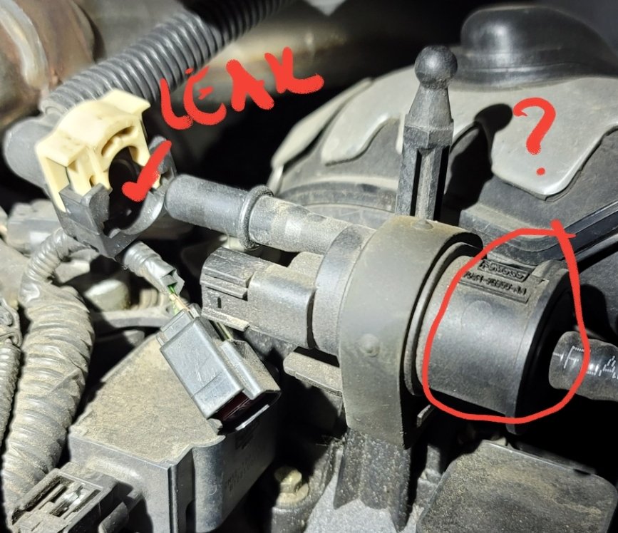

  1. I ordered part bb5z-9g271-b, will be here next week. It kind of looked like gas vapors had accumulated under the engine cover bc the top of it looked wet in some spots. Was hard to tell what it was bc the purge valve made everything smell like gas. Fingers crossed this fixes my issue.
  2. I can't find the part. Autozone, advanced, etc. I see the solenoid under the hood but I'm not understanding how its connected. The part # says it's for an F150. 9F945. When I removed 2 of the connectors that snap on/off. One of them spilled gas from the hose. I have a GMC Acadia that did this and the part looks similar. Why is this info so impossible to find? Looks nothing like the valve in all the youtube videos from this year model. I'm sure that hose isn't supposed to leak gas tho. I'll attach pictures. If I buy a new one, the hose that says flammable, is it reusable or do I need that part as well? In the photo the hose with the white plastic on the end is the hose that leaked gas. .
  3. I drove my wife's car today. When I put gas in the car, soon as I insert gas nozzle, I hear a hissing sound like it's relieving pressure. All the videos online show a purge valve under the hood. The 2 0 Ecoboost doesn't have that part. Think it's a fuel pressure sensor? Or do I need that spider leg looking assembly on the engine that includes the fuel purge valve? Bc I replaced what i thought was the purge valve under the driver seat. I just don't know why there is absolutely no info on the 2 0 Edge, only the V6 with purge valve under the hood.
