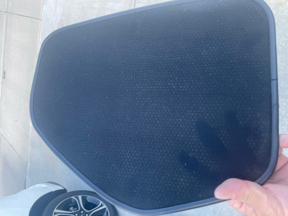

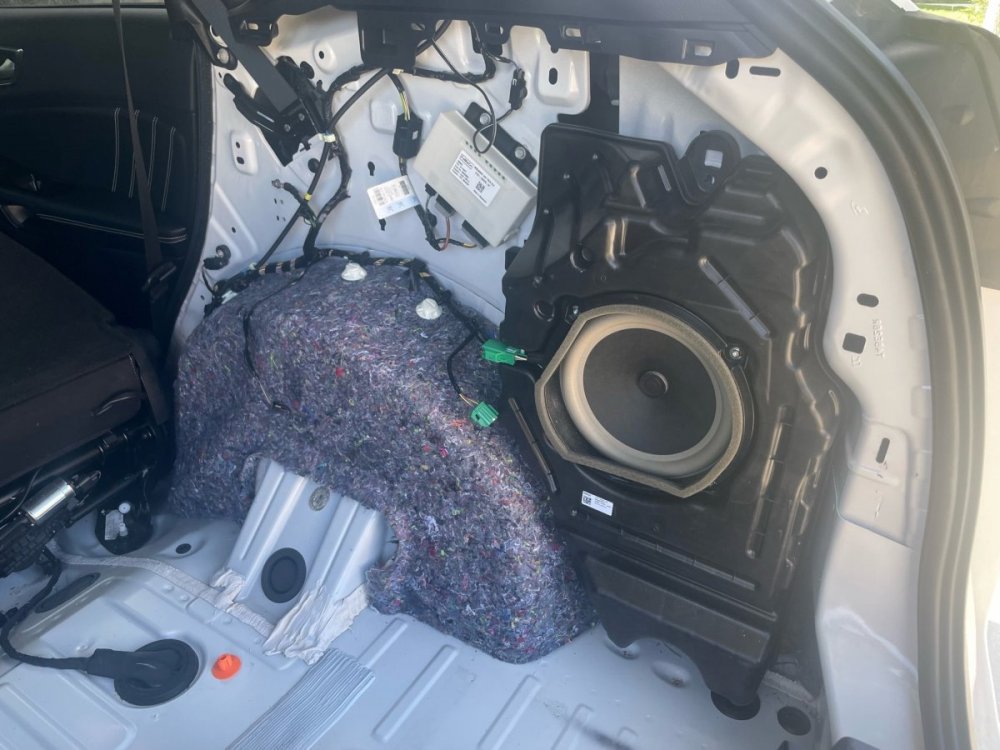

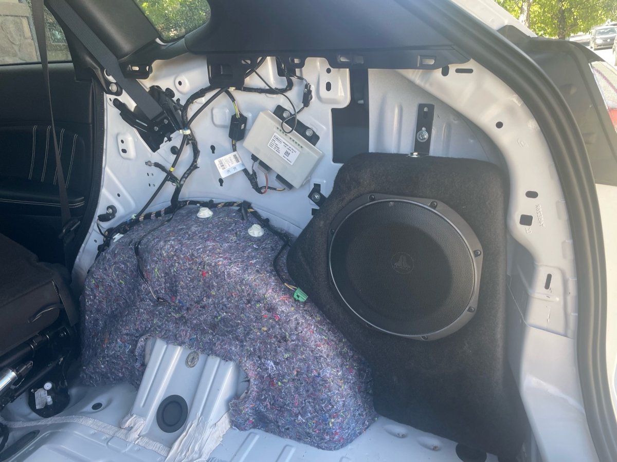

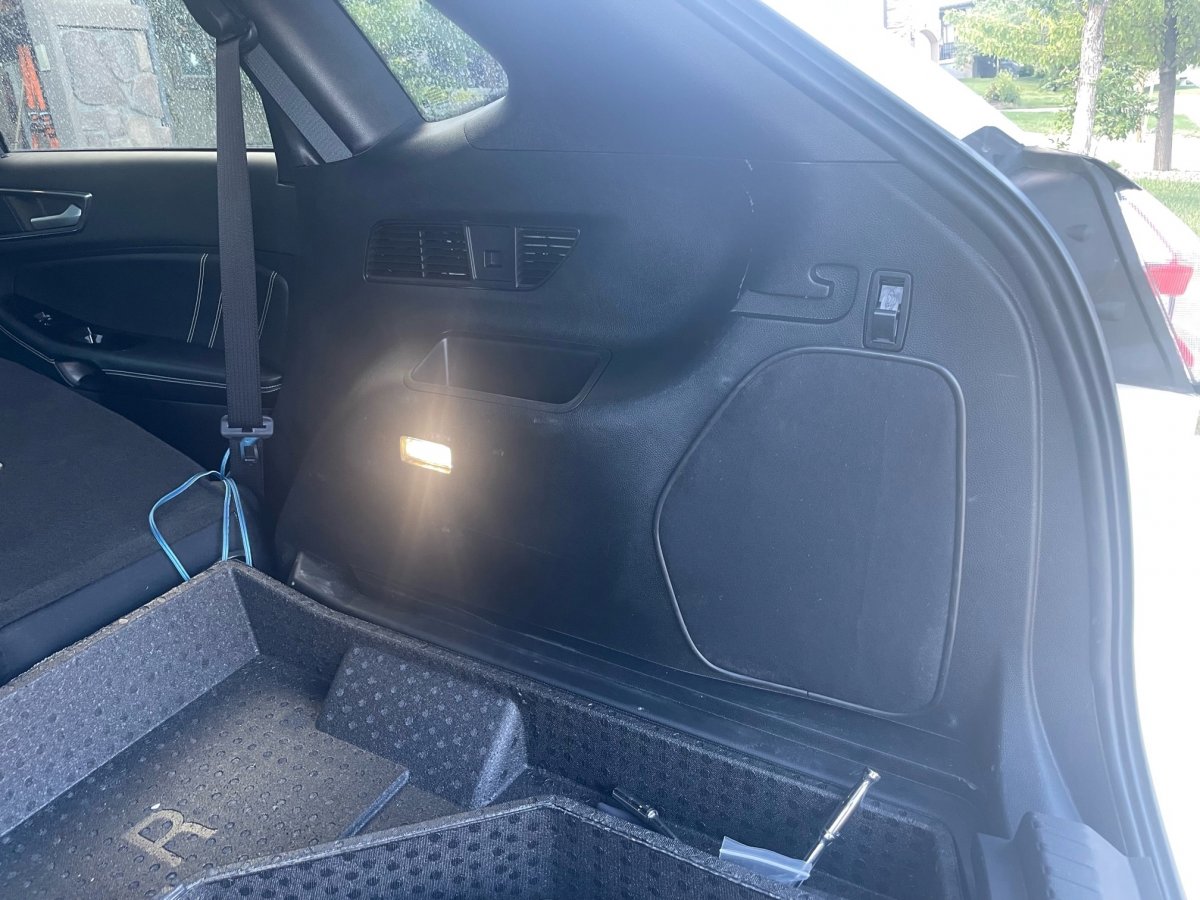

  1. I just finished install installing a JL Stealthbox in my ST. I was just going to attach some pics and thoughts as I had not seen many on this topic. Total time to install box was maybe an hour however I did not do any sound deadening as it wont be here until the weekend. I reused old amp and equipment other than the sub. I went in with low expectations and came out impressed. Once installed I hooked the sub to the factory amp just to see how it did and it was noticeably louder and punchier than stock. Once my amp was hooked up it was completely different and I will need to add deadening material to cure some rattles. The goal was to not lose any cargo space and improve the bass output which this box worked perfect for. Can anyone tell a difference with ANC disabled or the rear mic unplugged? I have not been on the road long enough after install to tell. I followed this thread for the amp install Here is the factory sub with all panels out JL Stealthbox installed The grill that comes with the Stealthbox and finally the panels reinstalled

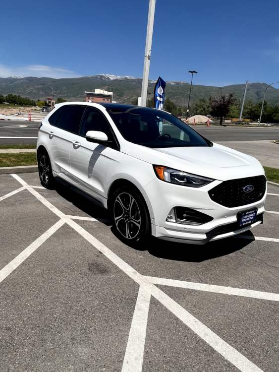

  4. Here you go. I need to get some better ones.

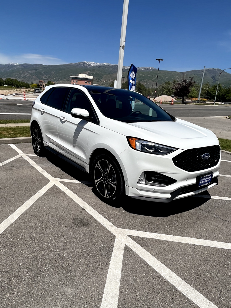

  5. Just picked up a 2020 edge ST!
  6. this looks awesome. Need a CF engine cover to match
