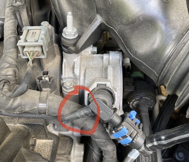

    PROBLEM SOLVED: So this was definitely the problem. I went to my local Ford dealership and provided the part number but you had to buy the entire vacuum hose system. He told me he didn't even want to tel me the price. I went to my local parts store and just purchased a length of rubber vacuum hose and installed. Drove it for a while at steady speed and no issues. I believe the leak was preventing enough pressure to overcome the turbo pressure on the wastegate that would build up at steady speed. When driving around town there was enough adjusting the throttle to not build up pressure.

    So I did find a very clear vacuum leak but need help identifying the part. It is the vacuum line that goes to the left and circled in the below photo. Does anyone have a good diagram they can look up the part on? Not visible in the photo but it is cracked on the underside and hisses really bad. Not sure if this would affect the turbo but I figured it probably isn't good anyway.

    Thank you! Ended up getting P1016 wastegate Control Pressure Higher Than Expected with a recommendation to replace the turbocharger wastegate solenoid. Finished this afternoon and it seemed to fix the problem. Last night it did it again but I was able to prevent by not maintaining speed. Seems to only happen when I maintain a higher speed for a while.
